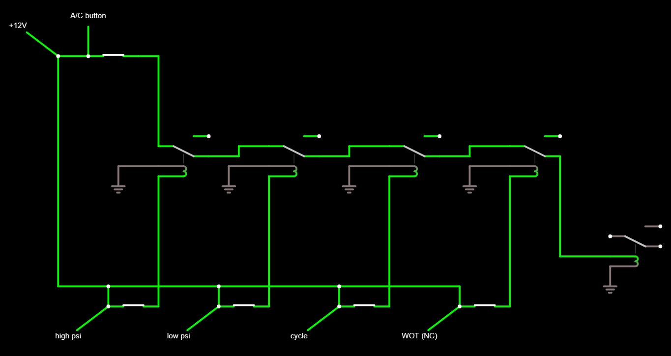

  2. I'm going to be swapping engines later this year and the current ECU is going to go away. Currently there's three pressure switches that go to inputs on the ECU to monitor for air conditioning compressor activation. What most people do on engine swaps in these cars is to just wire those three switches in series to the compressor relay. However, I'd like to use them as inputs to an arduino or PLC and have LED indicators for each switch, but I've also read that arduinos do not like to play nice with vehicle electric systems due to noise and spikes and whatnot. I think I can do it using just relays, but that could get bulky. Is there an arduino like PLC more suited for vehicle applications?

I'll probably stick with the relay chain. Here's what I've got going so far. I found relays that have an LED indicator when activated and I'll need to find a circuit that lights when one of the switches is open to show a fault.
Any thoughts on the first one?

Resistors are commonly used for coil suppression on automotive relays. The reason is that they allow the field to collapse faster than a diode and therefore break the contacts faster and prevent contact erosion better. The tradeoff is a higher voltage transient than with a diode and this is handled instead in the ECU.

From what I've read, it's supposed to do a similar job to the flyback diode but isn't polarized and isn't as good as the diode would be.
Davies Craig who makes the module also sells replacement 24v relays for different applications so they should be replaceable. I didn't have any luck just pulling on them so they may require a gentle prying. If that's the case then I should be able to replace them with integrated diode relays after double checking the polarity which seems like the safest way to go since I don't have a clue what the circuit is like inside the ECU. I would hope it's protected, but who knows and I'm just a newbie still so I probably wouldn't even know what I was looking for if I tore it open.
As for the voltage dividers and drivers, like I said I'm still new enough at this that they're hard for me to grasp. Harder than simple relays and software code anyway. So for the time being I think it's safer to stick to the relays.

I got some diode protected relays from Amazon and I tested one just putting the coil wires on the battery terminals and it triggers in either polarity, but did I kill the diode when I hooked up in reverse? (EDIT: From more reading I think I probably did.)
I was thinking it wouldn't trigger in reverse polarity, but the diode is in parallel to the coil so I don't know why I was thinking that. And how would that apply if the sockets on the fan module are in reverse polarity? It wouldn't matter with a resistor, but would it still work and just not provide any protection? Is there any simple way to test for a spike or verify the diode is working properly?
