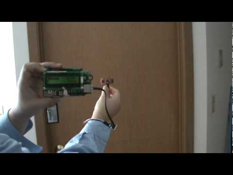

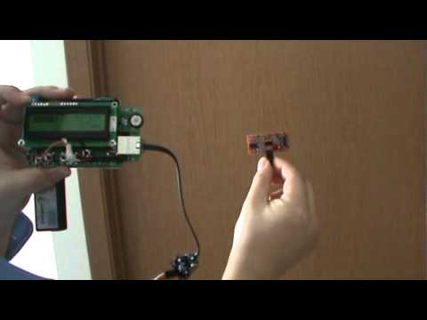

This is for my wife. She deserves a tech gift for putting up with all my wires and tools lately! :smiley:
I made a car rear obstacle sensor with audio alert. You can see how far something is behind your car when backing or parallel parking on LCD, both analog bar graph and digital readout. Plus it beeps like a Geiger Muller sensor when it comes closer and closer to an obstacle. I’ve tested it with a 12 ft phone cord. It’s good to go on my car for a field test!
I’ve made two versions of the code, a nutshell version which turns on and does what I said it does, then the fully interactive version with all the menus and adjustable parameters so if you want earlier audio warnings or want it off, choose from parameter list and customize it! This hopefully helps beginners (nutshell) and advanced users (full)! Leave some feedback!
If you like the shield, you can buy it here:
http://dipmicro.com/store/JL-PHI-1
All details and codes are on my blog page:
Pic:
Videos (watch the bar graph!):

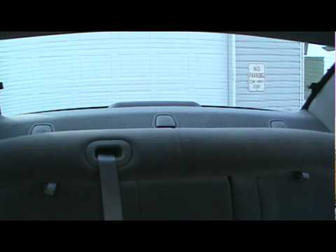

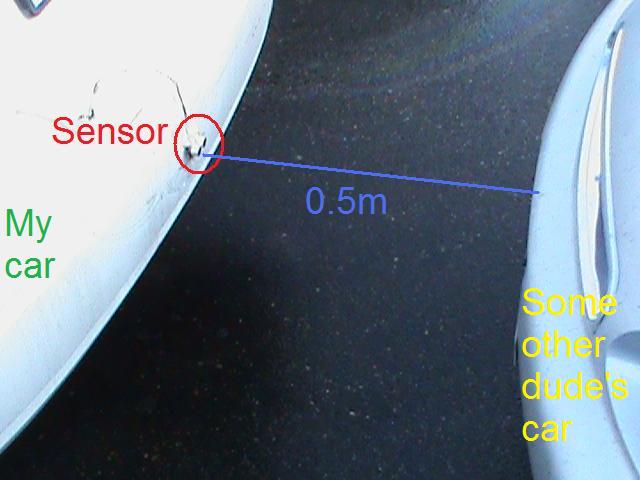

Update: it's warm today (by our local standard) so I got out and installed the sensor with my wife. It worked!
12FT 4-wire phone cord, about 10 pieces of wide tape and some masking tape later, the sensor is on my rear bumper sticker. I had it on my trunk first but it is angled and too high. It couldn't detect a car but a garage door was fine. So I moved it to the middle of the rear bumper cover.
Inside my car:
Between my car and some other dude's car:
The mounted sensor:

Very cool project. Hope the blind-faith test goes well.
But seriously dude, you need to work on your sensor mounting skills. :D
I say go with either hot glue or double-sided tape. ;)

Thanks! Forgot to mention I got some 3M "velcro" stickers with adhesive backing. Will plan for next weekend. Too much exams to grade. With cold weathers like in my area, you gotta be able to remove these sensors at night. I don't have a garage, although with my arduino spending I could rent 2-3 garages :) You just have to stick to what's more important! :grin:

Alright! I suggest you got get two sonic rangers. Since I've installed my sensor, I've grown an additional sense: every time I drive, I look at the rear bumper covers of the cars in front of me. I've seen cars with 2 or 4 sensors spread around the bumper evenly. I think you will want wide angular response as well but mine was narrow so it measures more or less things directly in front of it and not so much for things on its side. Having at least two will be much better than one. You can use your display to show two bars, one for distance to obstacle on each side.
