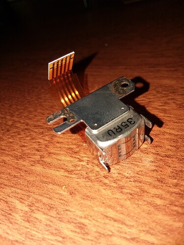

hey,
does anyone have a clue on the pinout of this casette tape head. i plan to replace this with an aux signal so i can plug my phone into my car. (which is obviosly pretty old)
-8 pins on physical head
-4 wires leave on one side
-other 4 are connected together to one wire
thanks
this is the other picture

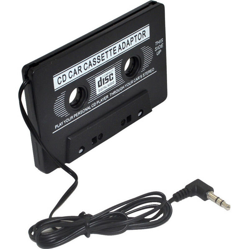

These devices are (or were, at least - maybe not so much anymore) readily available to play audio from portable devices in cars with a cassette deck but no aux in.
doing the mod you described would be easier if you were to trace out the circuit and inject your signal after the circuitry that converts the signal from the magnetic tape head into a normal audio signal.
Here's one of those commercial adapters, $1.58 USD w/ shipping from Hong Kong:
https://www.ebay.com/itm/311687553437
They were the key back when the Discman (portable CD player) came out. I think they were still pretty common during the age of the MP3 players too.

yeah im gonna try that ig and then if i cant get the pinout to the main board after reverse engineering it (it has like 18 pins just for the casset circuit connection) and then if i cant get that ill do what paul said
do u know y there might be so many pins?
i would think it would only need the left and right and a few pins so say when to control the motors...
i dont really want to do the adapter because i already spent a long time taking it apart and i dont want to put it all back together for nothing lol idk
also i want planning on making it more permanent (though i guess it doesnt really matter)
If that's an auto-reverse deck you probably have 4 coils (in one head/housing). 2-wires each with one grounded.
Looks like a 4-track head. Very ancient. Use a DVM to verify my thesis. The one row with all the pins bridged together is ground, and the other four go to a winding in the head.
You can use a standard audio amplifier. Connect each of the four pins, one at a time to the left-in on the amplifier. Cover the head gaps with a thick piece of paper to protect it, then tap a magnet (weaker is better) on the head. Your amplifier should give a loud pop. If I am right that it is a 4-track head, then all four pins would produce an audio pop from a magnet.
What did the head come from?
