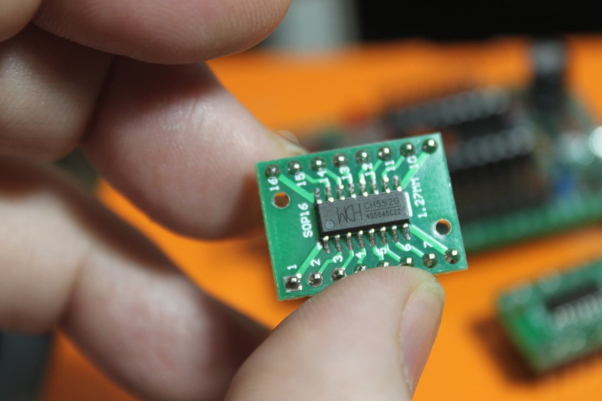

I assembled my own module very similar to the scheme with ch55xduino, but my Ubuntu does not see the ttyACM0 port.
I used a brand new CH552G processor purchased on Aliexpress, straight from the protective packaging. Obviously, I need to somehow write the bootloader there. How to do it?

Very strange. I have two processors installed on expansion boards. Now I've tried both. To my surprise, they give out different dmesg.
First processor:
[280120.028274] usb 6-3: new full-speed USB device number 59 using ohci-pci
[280120.217308] usb 6-3: New USB device found, idVendor=4348, idProduct=55e0, bcdDevice= 2.50
[280120.217329] usb 6-3: New USB device strings: Mfr=0, Product=0, SerialNumber=0
Second processor:
[280416.756129] usb usb6-port3: unable to enumerate USB device
[280479.799119] usb 6-3: new full-speed USB device number 106 using ohci-pci
[280479.959128] usb 6-3: device descriptor read/64, error -62
[280480.227121] usb 6-3: device descriptor read/64, error -62
[280480.491117] usb 6-3: new full-speed USB device number 107 using ohci-pci
[280480.651113] usb 6-3: device descriptor read/64, error -62
[280480.919088] usb 6-3: device descriptor read/64, error -62
[280481.027115] usb usb6-port3: attempt power cycle
[280481.767075] usb 6-3: new full-speed USB device number 108 using ohci-pci
The processors are the same, although most likely purchased at different times. Both have the same inscription: WCH CH552G 405845C22.

In both cases, I have all the electronics in common.
Only the processor on the expansion board is changed. There isn't even a single resistor there.
Maybe this is a defect in the processor instance?
Might be defect, but more likely it's clean without preloaded firmware. IMO you need the WCH programmer for the first flashing.

Should work, but you never know. But your chip in the picture is CH552g, not CH52... just to make sure. Have you seen this: https://www.youtube.com/watch?v=9g-lvh9AS-8
Thanks a lot for this tip. The first time I wrote without glasses, and then I pasted it with copy-paste. I think I've corrected everything...
