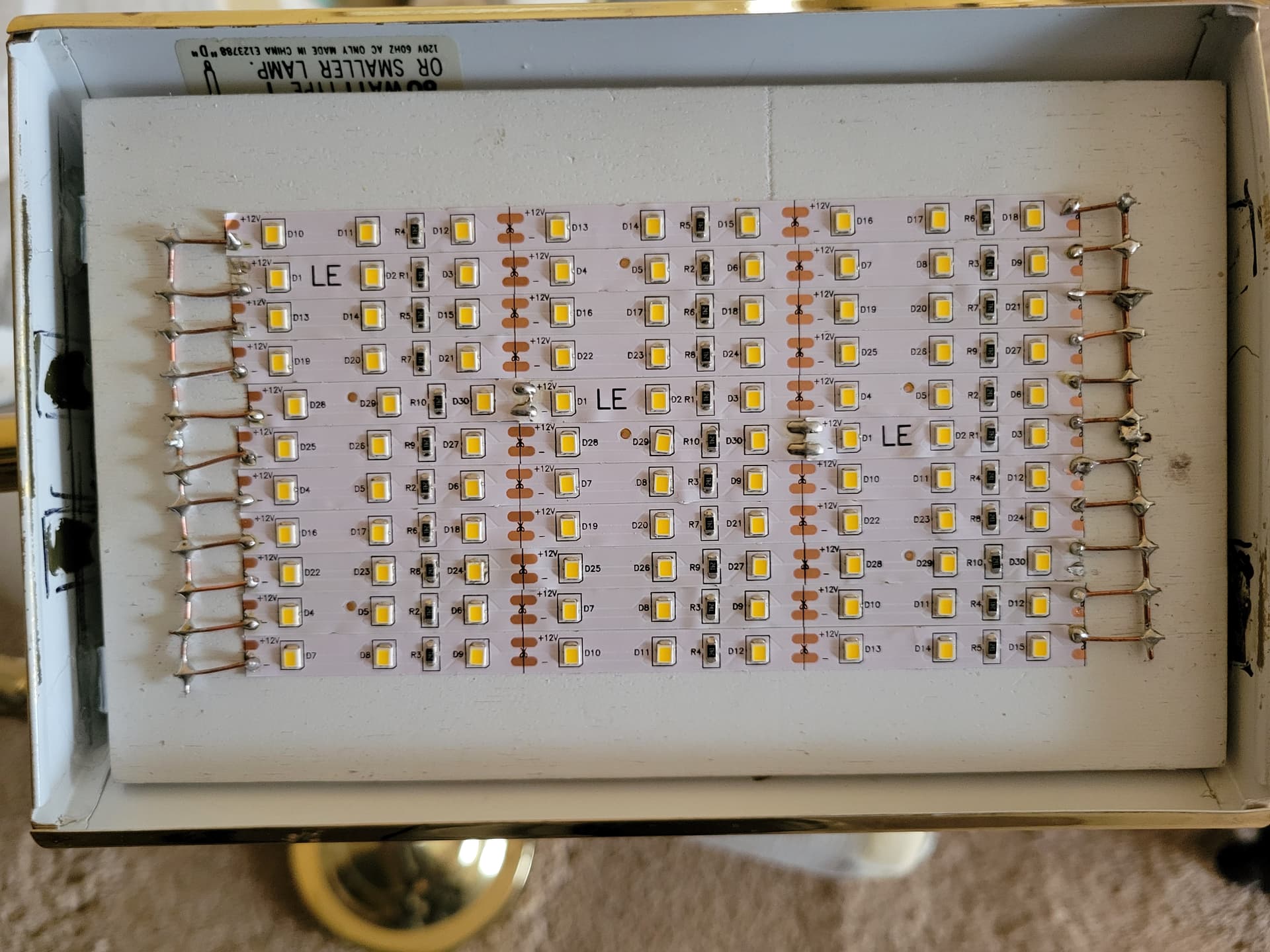

I guess I should have included info on my LED light panel at the start of this whole conversation. Apparently the strips I used to constuct it already have the requisite resisters built in. I've been using this light for several years now without a problem. Here's an image of the light panel.

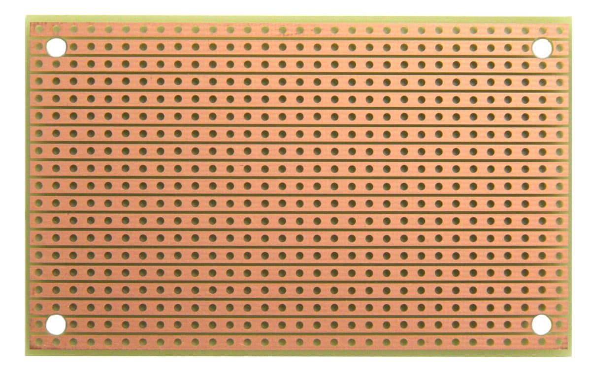

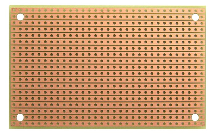

If you want to make it smaller, you can design a dedicated PCB and let that be produced. You can design around a SparkFun Pro Mini or Arduino Nano.
Alternatively you can use some strip board like below (just one of the first images that I could find; ST1 | StripBoard-Size 1 | BusBoard Prototype Systems) and solder your stuff on; I would advice to us a socket for the Nano or Pro Mini so it can easily be replaced.
