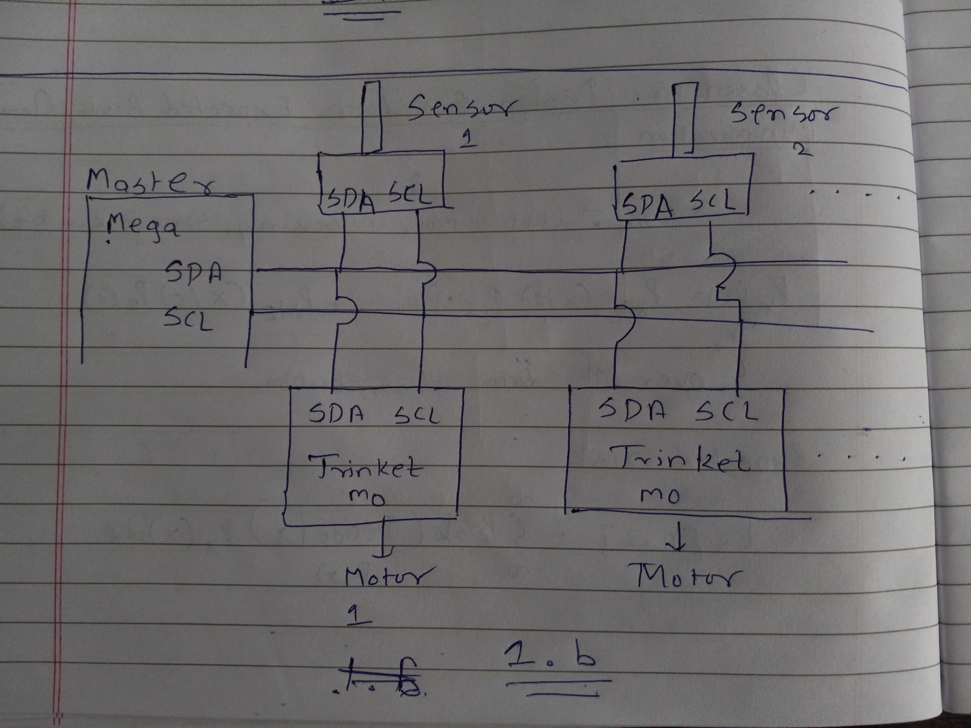

As I explained I have a sensor that can communicate over I2C, a Trinket M0 board and Arduino Mega. So, what I did is I used Wire.h library and Initiated Trinket as a master which will take data from sensor. Although I not reading sensor values yet. Then in function I called Wire.begin(address) again and received value from the Arduino (Master). Then I started the reading values from sensor over Trinket M0. This system just works fine for one Trinket M0 board, but I need multiple Trinket boards. I will attach my code and schematic, please let me know if I am doing anything wrong.
So to avaoid this problem I think using another pins
on Trinket for I2C will help to solve my problem.
sketch_feb10a.ino (1.3 KB)
Uploaded the Schematic as well as code please check.

Looking at your existing diagram, have you got different addresses for each of the untis on the I2C bus?

I am sorry but I can't fully disclose my project here. The information I gave you is necessary as I mentioned. I can't remove any sensor or use one than multiple.
I just wondering if I can somehow set GPIO pin as SDA and SCL on Trinket M0.

The SAMD21 processor on the Trinket M0 has 6 SERCOM modules. Each of them can be configured for a form of serial communication (UART, SPI, I2C, ...). Time to consult the Trinket's schematic and the SAMD21 datasheet :wink: Verify that at least 2 SERCOMs are broken out (not sure how that works).

As @sterretje mentions, it's possible to create additional hardware I2C ports on the SAMD21.
