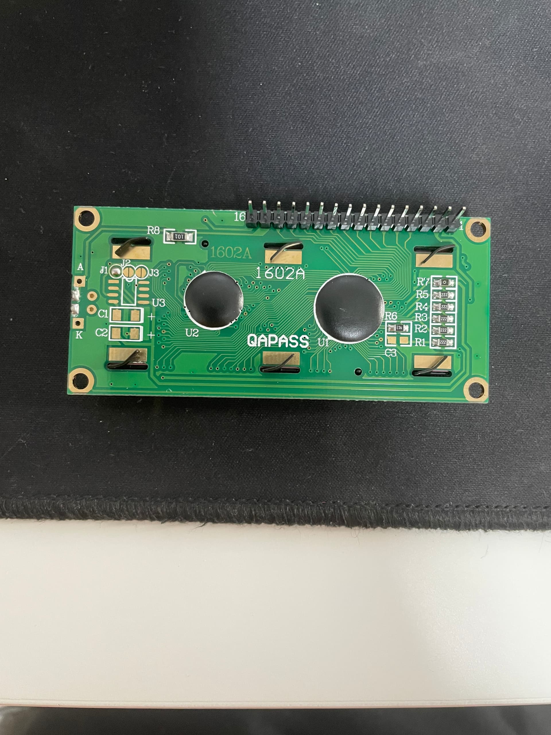

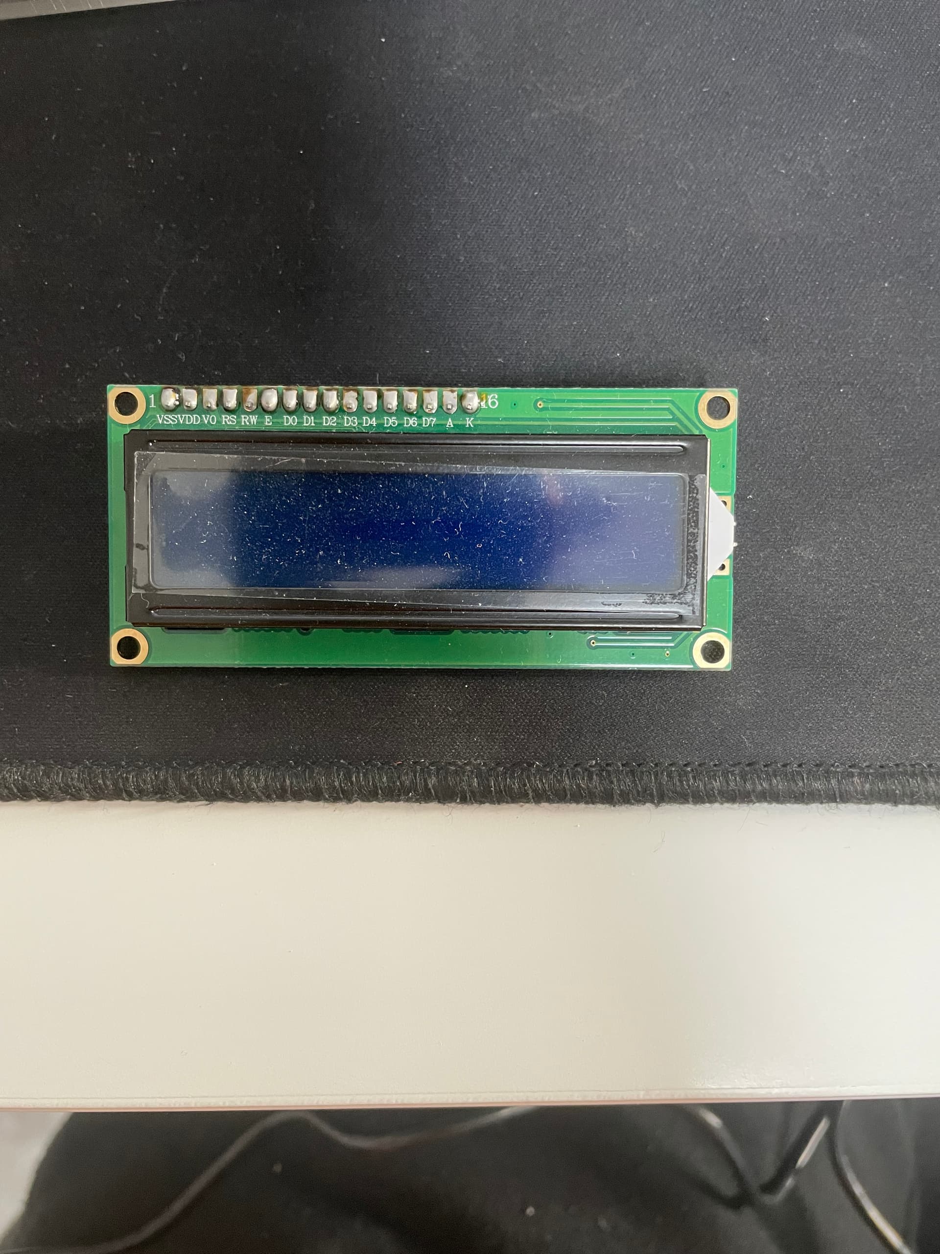

Here are the photos
That is a plain-vanilla parallel drive LCD probably using the standard liquid crystal library, not the liquid crystal I2C library alluded to above. The supplier should also have the library, although it may be included in the IDE these days.
Nano and Uno are very similar, the code will probably run on either without any modification. (Assuming you mean Nano V3 and Uno R3.)
So get an OLED and you should be good to go.
Your LCD is not a good substitute for the OLED, and even if that were not so, the code changes required would be beyond your expertise at this stage. Keep the LCD for another project.
