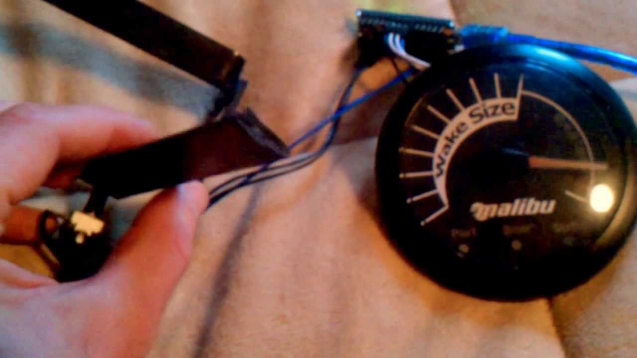

as part of my first real in depth project i want to incorporate an analog looking gauge that will show the angle of a hydrofoil (aka 'wedge') on my boat.
I started with the 'motorknob' example in the stepper library and am modifying it to meet my needs.

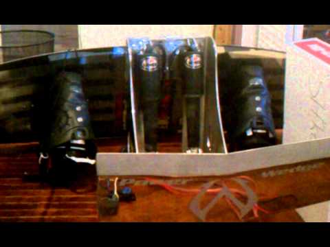

The hydrofoil moves from a stowed position out of the water(0 degrees) to a 'functional' angle that is about 75-90 degrees. those 15 degrees is what i want to precisely control and display it's position on my gauge. That leaves 74 degrees that is relatively useless on my gauge (not completely useless as i do want to know it's approx position while it's getting deployed). I am measuring the angle of my hydrofoil with a linear 10k pot atached to it's pivot point.
This is the hydrofoil:
and here is how it'll be mounted on my boat:
Here is a video of the actual gauge's layout (the plastic piece is just a proxy for the real wedge):
the 'deploy' area is only useful to show me that the wedge is moving from 0 degrees to 75. there is no need for me know the precise angle. So in my code i figured i could remap my sensor's values so that when the pot is is more the 75 degrees it'd 'sweep' a larger area on the gauge, increasing accuracy for those 15 degrees. On the flip side, when it's less the 75 it is represented by a much smaller area of the overall sweep so i adjusted the sensor output with another map function. The problem is, i start to lose 'sync' when the pot sweeps back and fourth.

I hope i was clear enough.
i know the issue is in the remap portion but i just don't know an alternative to fix the sync issue. any ideas on how to correctly code for something like this?
thanks in advance,
'scott
