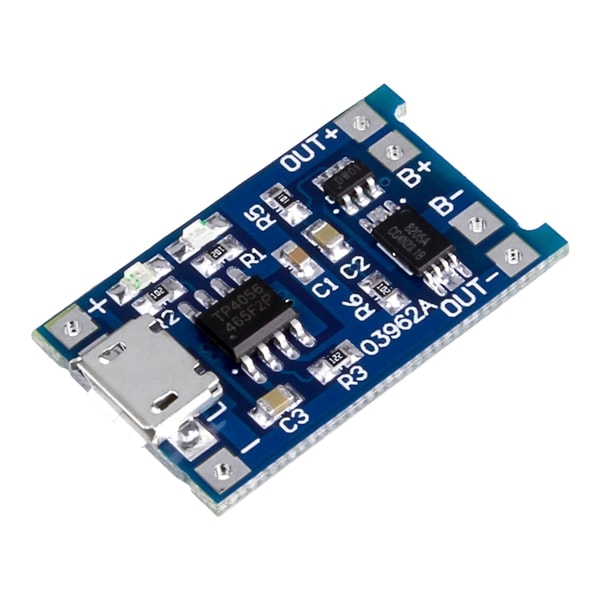

Charge and using Li-Po battery at same time! (like phones)
Im making a solar phone charger and a lipo holds charge.
I got this and this chargers, and i also have This boost circuits + this! but how can i charge AND drain or use the battery at same time? also i want it to charge device (no matter if it does at a lower current) when the battery ends!

The TP4056 chip mentioned in one (both?) of those chargers seems to assume its
a fixed charging cycle, so it may not behave quite as you want - if it thinks the battery
is charged it changes mode - whether it comes out of that mode automatically
when the battery is being discharged I don't know.
Datasheet here: http://dlnmh9ip6v2uc.cloudfront.net/datasheets/Prototyping/TP4056.pdf
This review says it starts charging again if the battery voltage drops below 4.0V.

Use the newer version of TP4056. It has pass through charging feature that charges the battery while separately powering your load. Even if the battery is fully charged the charger will not use battery unless input is disconnected or below min voltage.
Just make sure you connect your load only to the OUT+ and OUT- terminals and battery to B+ nad B-.

Do you actually mean you are using a different (newer) version of a charging board that just happens to use the standard TP4056 IC ?
Or are you saying that the TP4056 IC itself has specific versions with different capabilities ?
I meant newer version of that board. The board is usually known as TP4056 in ebay since it has no model number/name of it's own.

The low voltage cut-off is way too low, 2.4V.
The battery may go so low that the charger wont ever start.
The charger may continue to charge the battery whn its reached full charge.

OP should stick with protected cells since he obviously isn't very familiar with lithium batteries.
He could alternatively use a USB powerbank module instead which also has a boost function built in along with charging using a FM6316FE chip . Bigclive has a video on them

That's not a load switch, it's a battery protection IC just like lithium batteries usually have built into them. It's so you can use that module with unprotected cells.
