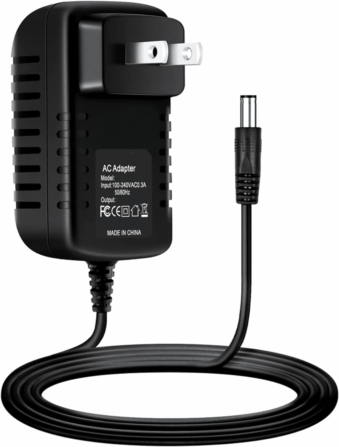

The charger is similar to this one

That's not a charger.
Do you have a datasheet for the actual charger?
That thing
should not be used to charge anything.
this is the link for the charger
it says its for 2S li-ion

That is not a charger
Package Included:
1 x AC / DC Power Supply Adapter
Interesting label...
Input 100-240V Ac
Output
nothing!
yeah i think the picture is generic
And actual label, what output it gives??
I should receive it on monday and I will be able to tell you
And how will you know?
Will you try to charge a battery?
Will you place a variable load on the output?
You could open the whole crap and post photo here before connecting to anything
