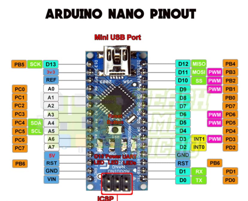

Pin 2 is NOT a PWM pin. Please explain (in detail) how your project should work.
Always used unsigned long, not int with millis timers. The int data type is only 16 bits on some Arduinos, and overflows after 32 seconds.
sorry that should be pins D2 and D3 both are PWM but that is not the issue. My question is why a float on my timer using millis() will work properly but a int with millis() does not, using int it enters the if timer statement 4 or 5 times in a couple of seconds ( see my code under //pump/fan in the global setup). My understanding is a float is a decimal point number and a int is rounded to a whole number

Sorry but D2 is not a PWM pin.
Hi Tom, you are right unfortunately the image I looked at for pin out is wrong I have now updated my schematic so now using pins 3, 5 and 6 as outputs. The motors and fly back diodes are undecided at his moment but will be around 1amp. VCC is 12v lead acid battery so voltage can vary up to 14v when charging hence the switching 5v. U4 is unconnected but will go to something like a SSR that will act as a latch circuit to disconnect the Nano and diesel heater from the battery with a push button to start the system.
