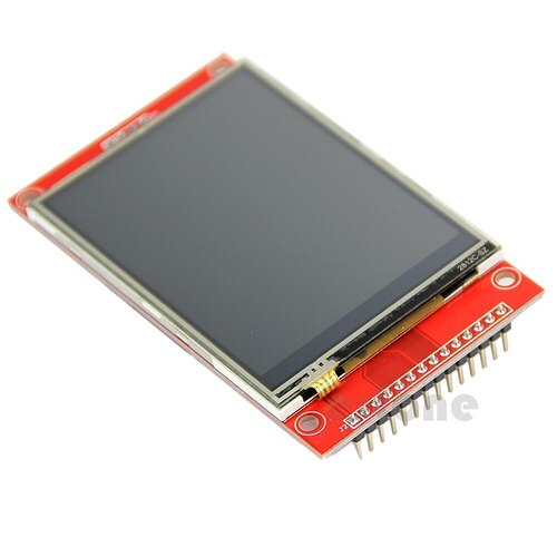

Hello Has anyone managed to have this kind of low cost Chinese display work as touchscreen?
I have a 2.8 inches one, the reference is the same except it finishes with 8.
I had it display texts and curves but couldn't find any instruction about how to wire it and how to use it as a touchscreen. Can anyone help please?
Thank you
Go on. The XPT2046 Touch controller is not mounted. Empty footprint for U1.
I suspect that the Touch panel is not mounted either. Look at the screen side. Is there a 4-way printed connection and associated ribbon?
The other clue is in the price. I bet it was cheaper than the display modules with Touch.

The 2.8" version has a similar pcb layout to the 2.4" pcb in your photo. Your photo has no chip in position U1.
It is always wise to post an accurate photo that matches the item on your desk. Simple enough from an Ebay 2.8" sale.
Buy XPT2046 chips from Ebay. Or ADS7843 or ADS7846 from US / European distributor.
Solder it to the pcb. The notch on the pcb legend shows which way round.
David.
Here are some pictures from the aliexpress site :
|500x500 |500x500 |500x500
Can you see that famous chip ?
Yes. Of course I can. Those photos show an integrated circuit U1 soldered on the pcb. Your photo in the Original Post showed an empty footprint.
What does the pcb on your desk look like? Does it have U1 mounted or not?
If there is an i.c. the Touch function will all work. I have the 2.4" Touch version. It works fine.
If there is no i.c. you will have no Touch.

I have exactly the same 2.8" SPI touch screen (as in your later picture) with XPT2046 touch controller chip. I used this to get started. If you have the tft part wired and working, the touch panel requires only one more Arduino pin for the chip select (T_CS). In the mean time I have gone on to develop my own calibration code using only 2 points to match accurately the coordinates of the touch screen with the tft display.
@David : I actually didn't check that the picture was the same as my display, sorry.
@6v6gt : Thanks, I tried that. I wired as in the ino code :
#define CS_PIN  8
// MOSI=11, MISO=12, SCK=13
//XPT2046_Touchscreen ts(CS_PIN);
#define TIRQ_PIN  2
But all I get on the console is : "Pressure = 4095, x = 0, y = 0"
Did I miss anything?
I ran the example on my Seeeduino board. (3.3V Uno ) It works fine.
Obviously my SCK, MOSI, MISO are on 13, 11, 12. Same as a Nano. But I don't have to worry about level shifting.
Note that any unused SPI devices must be unselected. e.g. external pullup or specific digitalWrite() from your program. You can only select one SPI device at any one time.
David.
You're lucky, I really don't understand why it's not working for me. I double checked and saw that I had the interrrupt wired on D3, do I changed to D2 but it's still the same : infinite loop saying "Pressure = 4095, x = 0, y = 0"... even if I don't touch it
