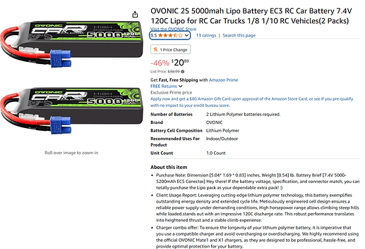

So I stumbled upon this one by OVONIC:
Two questions:
  1. Would this battery do the job? Is it overkill?
  2. I've seen some of your other responses on posts with similar questions where you suggest a step-down buck converter. Would that be needed here? If so what would you recommend?
If your servos are rated for 7.4 V operation, then the battery is fine.

Servos: ZOSKAY 35kg
Batteries: OVONIC 2S LiPo
I remember hearing that batteries may output slightly higher/lower voltages than listed and so I'm worried about whether it would negatively affect the servos.
Servo and battery voltage ratings are nominal, and actual battery voltage changes quite a lot during charge and discharge.

The linked servos are rated to be used with 7.4V 2S LiPo cells, which when freshly charged will measure at over 8.0 V.
