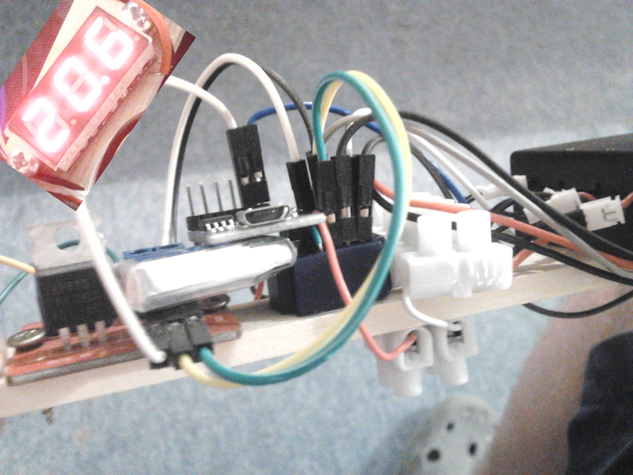

I do use 0.53$ Mosfet Button IRF520, its cheap, works with 3.3V as well as 5V logic, and has 0-24V output range:
https://www.aliexpress.com/item/0-24V-Top-Mosfet-Button-IRF520-MOS-Driver-Module-For-Arduino-MCU-ARM-Raspberry-pi/32285228133.htmll
But its not an H-bridge, so you can drive motor in one direction only. It depends on how near you want to go against an obstacle before you turn. If not too near, one direction is no problem. In this video you can see that eg a caterpillar robot can turn in place with one motor running while the other stops (in the video because the crash killed the 2nd motor cable connection):
Hermann.
P.S:
"Squeeze in 5th #Lipo between #IRF520 #MOSFET and #ATTiny85 (..."
