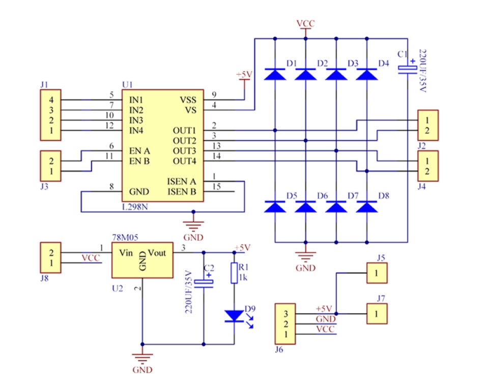

@TomGeorge The stepper motor is power rated at 1.5A 12V 45Ncm. I'm using a module, this omnipresent devise:
I suppose the one I got off Amazon is the same as the one on this spec sheet. I'm still going through the process of learning how to fully use it. Can I limit the amps to this thing from the arduino? Also, I'm using a Mean Well LRS-350-12 power supply.

That module has no current limit, so a 2.5A fuse will be needed.
Modules schematic.

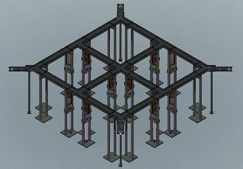

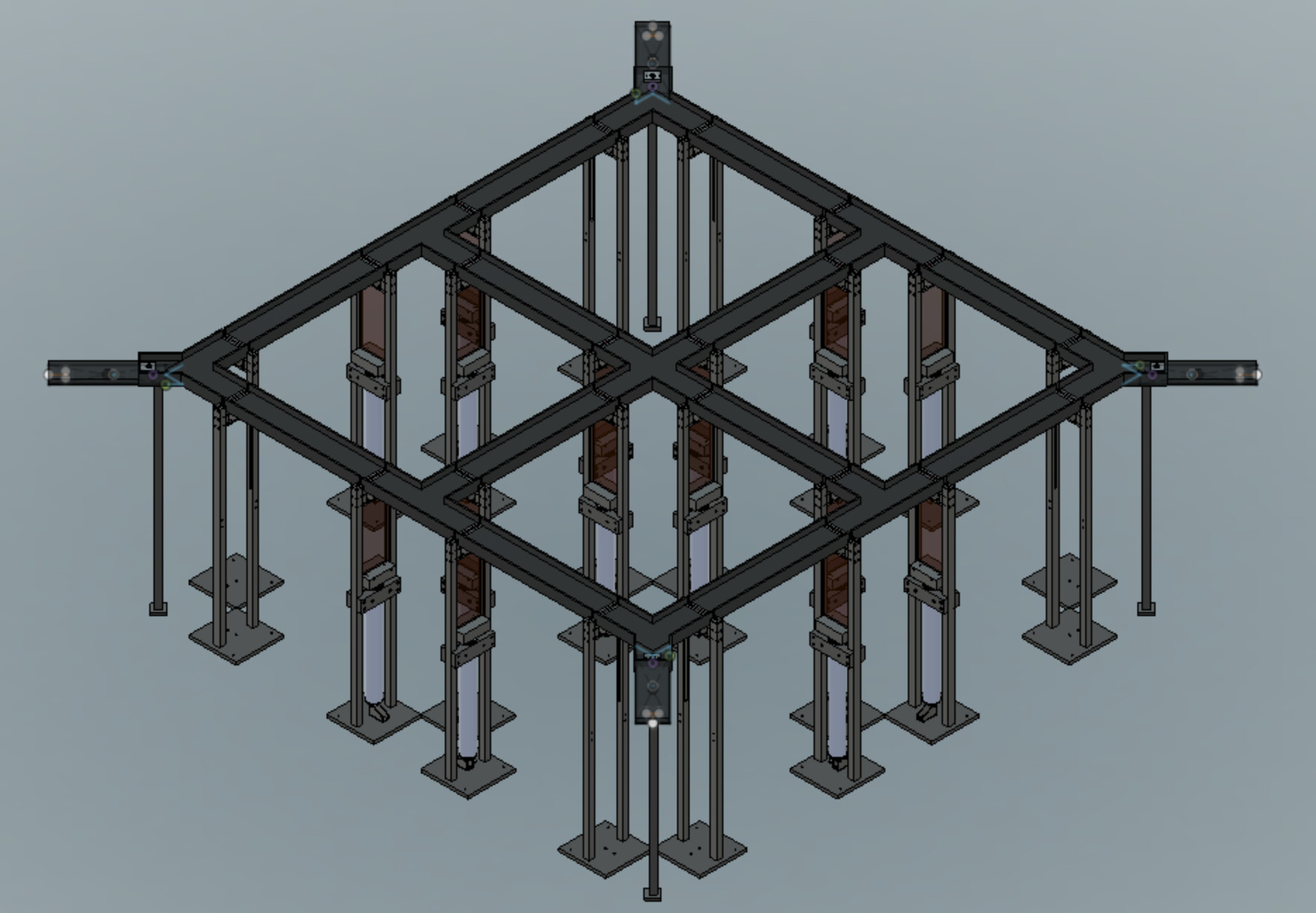

The overall application is a rodent behavior maze that is 2m x 2m square, with the midpoints of the outer track connected by a cross track in the middle. It has 16 barriers that are moved up and down with linear actuators. These are controlled by the BTS7960 modules. It also has 4 syringe pumps to deliver reward, these are controlled by the LN298. The syringe pumps are at the corners of the maze and groups of 3 actuators are at the midpoints of the outer track segments, with a group of 4 actuator in the middle of the cross. Each group of actuators will have its own power supply in a control box with the necessary microcontrollers and drivers in it to run that module. The syringe pumps will share a power supply with the module of 3 actuators as mentioned above. Here's a picture without control boxes and syringe pumps.
I have all the NANOs for two reasons. One there isn't enough output from a MEGA to control all this stuff. Two, I want the MEGA to be focused on receiving serial data from a computer and subsequently telling the NANOs what to do based on what serial input it receives. The computer is running motion tracking software that follows a rat on the maze, how the maze is configured -up and down state of the barriers and when reward is delivered - is determined by where the rat is on the maze and what choices it's made at intersections on the maze.

So, I'll have five 12V/30A power supplies (I mentioned that already right). These need to all share a common ground? This would end up being a lot of wire as they will about a meter apart. They'll be set up on the nodes of the plus, one in the center and the other four at the ends of the cross portion of the maze. Do I have worry about ground loops in a DC circuit? What about the usb power the namo and send signal info from the computer?
