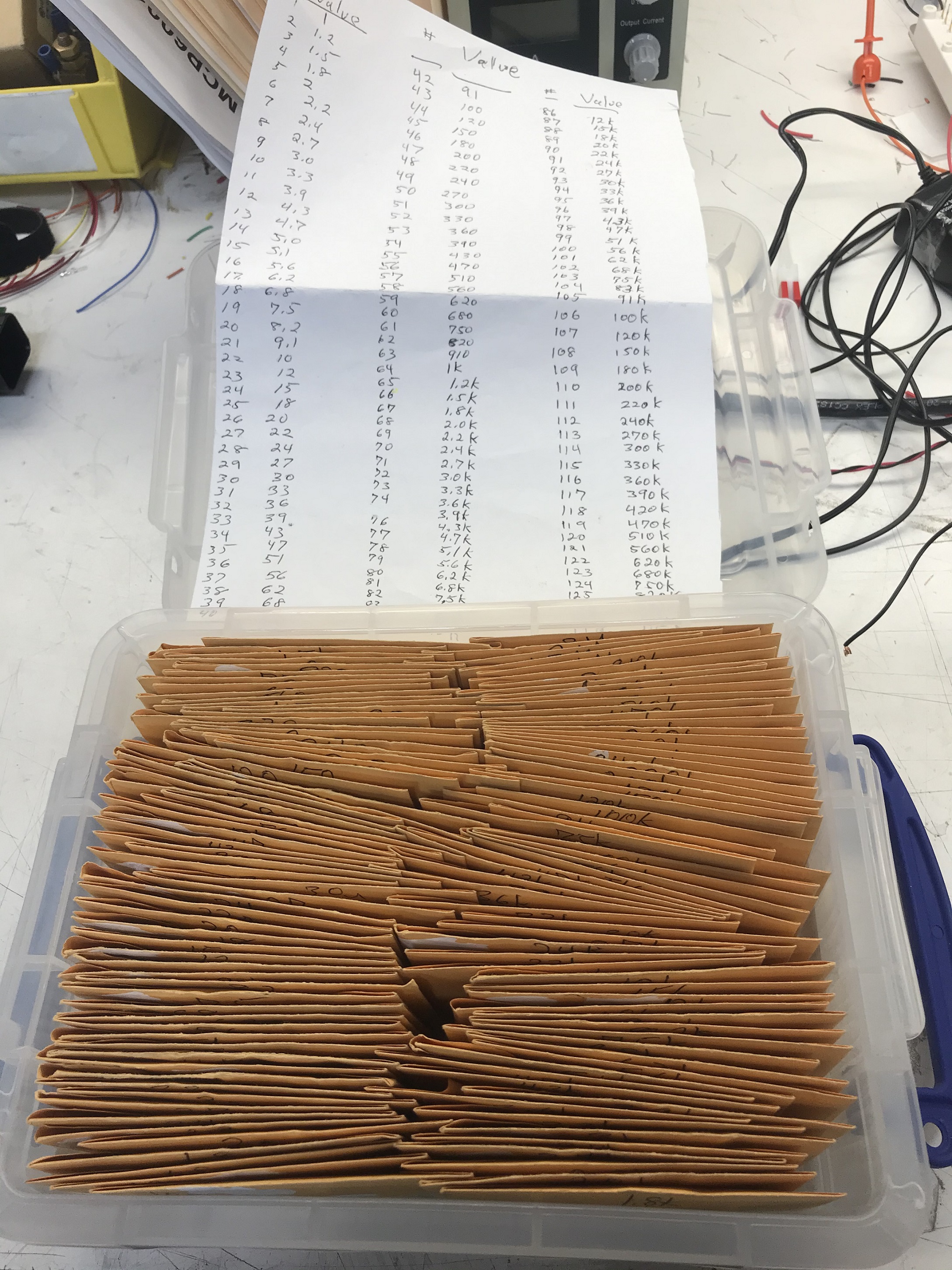

The standard procedure used by professionals is to buy a kit of through hole resistors and box of coin enelopes
or a plastic tray component cabinet and take the time to label the envelopes and sort them out by value.
