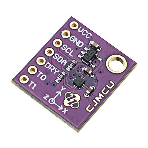

CJMCU-008 3 axis magnetometer
I've just received the above breakout board (see pic) from Bangood which initially I intend to use for a wind direction sensor, but cannot find any specs on it. It uses the I2C protocol so I thought I might try the Adafruit_LSM303_U.h library, but it does not recognize the device. Does anyone have experience with this board? If so I'd appreciate some direction. It has a C9UEBA sensor from ALPS on it. I'm using the Arduino Uno/Nano or the ESP32.

Post a link to the magnetometer chip data sheet.
If it is not an LSM303 chip (of which there are several different varieties) then of course the library won't recognize it.

This is the only 3 axis sensor on the ALPS site. It looks the same and has the same pin labeling but has a totally different part no.
And where on the web did you find this "ALPS" site?
Is it really that much trouble to post a link?
I'm sorry. I thought I had! Realy not that much trouble! I've sent them a query and am awaiting a reply.
http://www.alps.com/prod/info/E/PDF/Sensor/Geomagnetic/HSCD/HSCDTD008A_data.pdf
The HSCDTD008A is a typical magnetometer chip, for use in measuring the Earth's magnetic field, but is otherwise very different than any of the LSM303 series of chips.

Even a small "refrigerator magnet" can have a magnetic field thousands of times greater than what that sensor is designed to measure. You will simply overload it.
