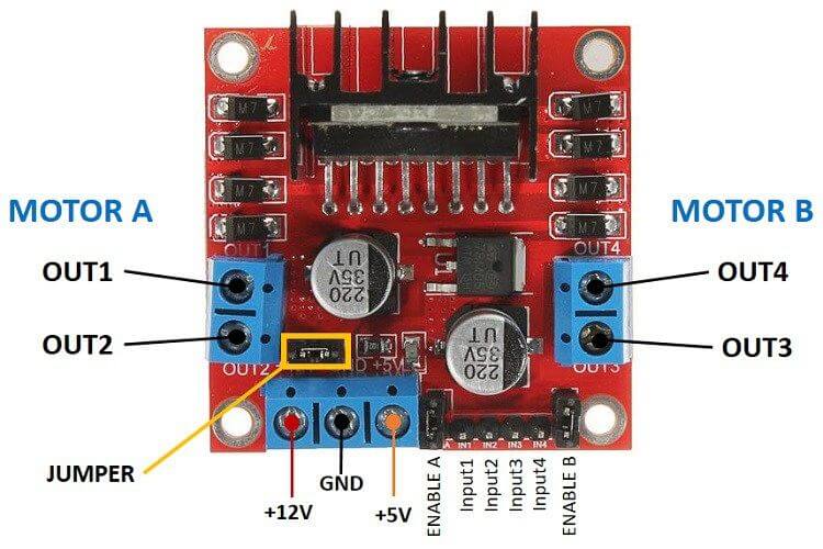

5. Can you post a picture of your L298N Motor Driver?
12V will be required for full speed. The motor will turn even at 4V terminal voltage, I think! The hobby Robot Car's tiny motor is a 6V motor; it turns even at 1.3V!!
Here is the picture of L298N, cleaning without water is to first do a good cleaning and after cleaning with water, the push button is so that if I notice that there is too much dust I can operate the cleaning manually through the push button. Can you help me with a wiring diagram???
