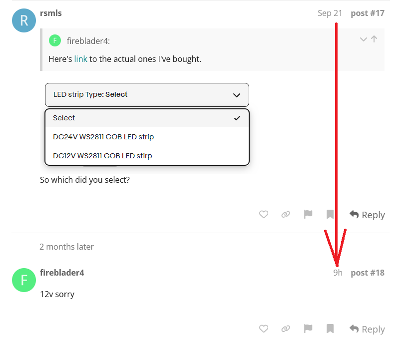

Here's link to the actual ones I've bought.
My description saying 12v 24v was because they had a few options.
So which did you select?
12v sorry
