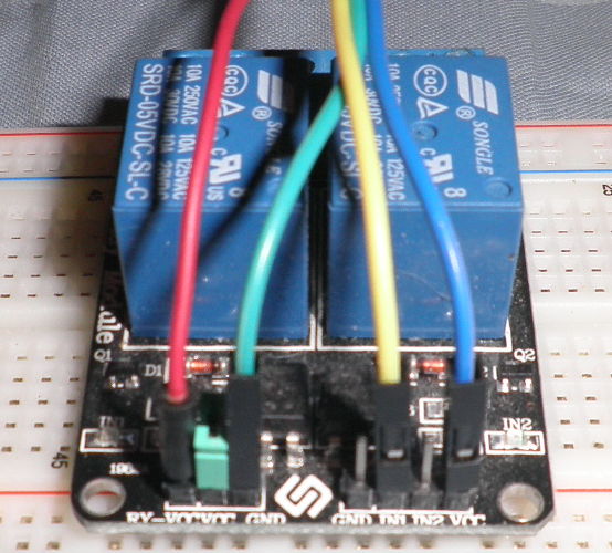

sorry everyone for taking so long to reply. So I thought the problem was the the pins were not switching from LOW to HIGH but i checked this by adding leds to the circuit connected to the pins and they light up meaning the pins are reading HIGH. But I still have the problem of the relay not switching. The relay stays normally open even though the voltage is set to high, which should cause the switch to close. I'm assuming it has something to do with DHT library but am unaware of a solution. If anyone has any threads where this has already been discussed could you please send me the link. I have also triple checked the wiring to the relay as well as tried a new relay in case the other one was bad but still nothing. Thanks again everyone.
What relay are you using and how is it wired? Suspect wiring error, most relays can't be driven straight from arduino pin.
I'm using a SainSmart 2-channel 5V Relay Module. The problem was the power supply i was using was not giving enough power to trigger the relay. But using USB its now able to trigger the relay, BUT it seems as though theres not enough power still? What is happening now is my relay switches to high, the lights I have connected to the relay come one for a second or two then switch off. After maybe five seconds the relay switches back on and the process repeats. I notice once the relay switches on, the LEDs I have connected start dim and then go out, but once the relay switches to off, the LEDs switch back on to full strength and this process repeats likewise.
Sounds like insufficienf power, relay turn on, supply gets dragged down and the board resets, and tries again.
Correct, so I need an external power source for the relay (i.e. not coming from the arduino)? Any idea the easiest way to accomplish this since you're right here? I'm sure I can figure it out myself with some time if you're busy so no worries either way and thanks for the help!
RED........External 5V
GREEN....External -
YELLOW..Arduino output pin (relay energized when pin is LOW)
BLUE......Arduino VCC (5V pin) (Arduino GND not required).
I am still unsure what to use as an external power supply. It's not the wiring I'm confused with, but what power supply is acceptable. Would using something similar to this be acceptable by cutting off the end and using the positive wire for VCC and other for ground?
What's an acceptable power supply to power my relay?
That power supply would work. ( since the relay has a 5 volt DC coil in post 14)
