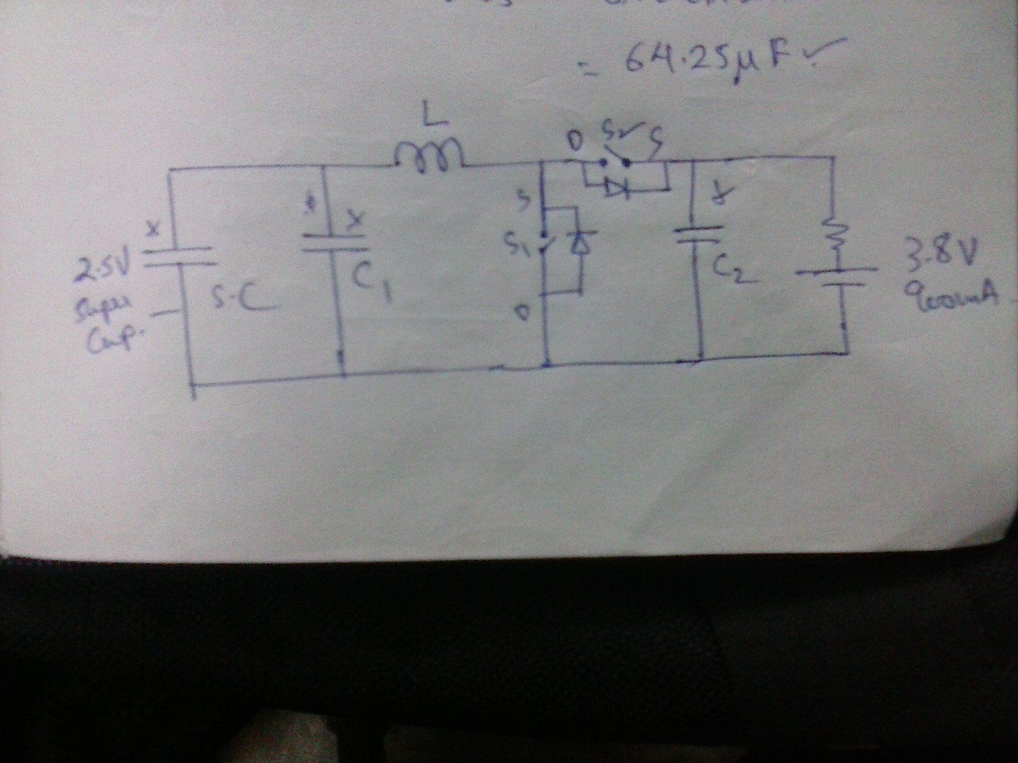

code for dc -dc converter
Im working on a dc-dc buck boost converter, with 2 different switching elements for bidirectional operation:

As per value of v1 the buck mode or boost mode gets selected.Im facing the following problems:
  1. The buck mode does not seem to generate a PWM??
  2. Ive used 2 seperate PID fns. ...can someone please check wether ive applied correctly? especially the output statement?
  3. I based the duty ration of buck & boost fn on the basic voltage eqn. for buck and boost converter...is that fine...and ive multipled it with output1 & output 2 of PID??
  4. The processor is heating up??why?
  5. Is the if ..else statement used for selecting boost and buck function correct???
Ive attached the power circuit diagram for your reference..
Please help have a project submission.....
Thanks & regards
Emmanuel

The S and D markings on your "switches" seem at odds with the diodes marked.
You have no high-side driver?

Thanks for the reply...
I havent shown the driver but ive considered the same...its a TLP250 opto -driver....ill correct the S..D foul up...
The value to pins are integers??

Where does v1 change in that loop?

Please post a complete schematic, including the Arduino connections and optoisolators. You will need it to get a good grade on the project, anyway...
Then maybe we can tell you why it is heating up. Or it will dawn on you as soon as you look at it.
v1 is from analog pin 3, it is connected to a supercapacitor which discharges from 2.5V to 1.5V...
Now answer my question:
aarg:
ok...will do best i can to put it online...
Ok...v1 is not updated in that loop....right?i.e i havent called the analogRead there...?correct?
