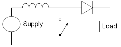

For a project we needed to make a boost converter, after our IC died. We decicded to use a PWM channel and an analog input of our microcontroller (PIC18f22k23).
Now some co-workers pointed us to a PID controller for the feedback line, after some reading I made the followings concept programs.
first I read the analog voltage with the ADC, then I calculate the difference, delta, between the SetPoint and the output voltage, and last the PWM gets incremented with delta devided by a factor K, which increases the output voltage. The factor K is here to prevent an overshoot, theoratically the output voltage will only "aproach" the SetPoint Voltage.
output_V = analogRead(A0);
delta = setPoint - output_V;
pwm = pwm + delta / K;
However It will take a significant time for the boost converter to reach the SetPoint voltage, so when the frequentie is to high, It will overshoot due to pwm being incremented to often. To prevent an overshoot I could either lower the frequentie and/or increase the factor K for better dampening.
I tried to make a better program where factor K is regulated. I calculate K by the substracting the delta by the previous delta. So how higher the output voltage gets, how smaller the differences gets and how larger factor K becomes... atleast that is what I want.
output_V = analogRead(A0); // reads output voltage
delta = setPoint - output_V; // calculates the difference between the setpoint and the output voltage
error = delta - delta_previous; // error will be used to calculate the factor K,
pwm = pwm + (delta / (1024.0 - abs(error))); // A high error results in a low K, which results into a faster time, error should not become negative as it will result in slower correction, and the 1024.0 - K is because the error workes inversed proportional.
delta_old = delta; // store delta in delta_old.
Am I on the right track here? This PID controlling is new for me. I am going to need it for my 2 wheel balance car in the future :wink: and perhaps also for my quadcopter.

It would be much easier to use voltage feedback and the built in analog comparator. Boost converters are by nature switching devices, with capacitors to smooth the output. You do not need the sophistication of PID.
You also do not need PWM, that happens automatically if you switch off the output port when the output voltage is too high, and switch it on again when the output voltage is too low.
when I power up the coil for the first time, the output Voltage will not reach the desired 13V... as it never will rise above the 13V it will not switch off. So there won't be any switching at all. You need fast switching in the beginning to reach the desired voltage. I have looked up to make a boost converter with comparators but have you got any idea how big the schematic becomes. you need 2 comparators a memory cell, seperate clock line and several resistors and capacitors arround the comparators. So that is the same as buying a new boost converter IC. It is 10x easier and require infinite less components to use a PWM line, and read in the output voltage via de resistor division, which we already have.
...then I calculate the difference, delta, between the SetPoint and the output voltage...
Surely you mean between the setpoint and the input.
You are correct, it is slightly more complicated than I summarized (but not much). You need a short pulse of current to generate high voltage from an inductor, and the on time controls the voltage value, up to a limit depending on the inductance and resistance.
It is easy to use a PWM module to generate the pulse, but that is not necessary. The following example is similar to what I had in mind, but use of the ADC is also not required -- the voltage comparator will do the same job. Note that the writer simply increments or decrements the on time as required to achieve the desired voltage. PID would just over complicate the issue.
I solved the problem. Now my code has become what it is now I tend to better understand PID explainations found on the internet 8) .
My code is as follows.
void loop ()
if(Serial.available()) {
setPoint = Serial.read() - 48;
setPoint = map(setPoint, 0, 9 , 100, 400);
// setPoint = analogRead(A0);
// setPoint = map(setPoint, 0, 1023, 100, 400);
output_V = analogRead(A1) ; //
error = setPoint - output_V; //
error = map(error, 0, 1023, 0, 255);
integrator += error;
integrator = constrain(integrator, (-255 / Ki), 255 / Ki); // don't really need a coworket pointed me to this
pwm = error * Kp + integrator * Ki; // Kp = 1/2, Ki = 1/4
pwm = constrain(pwm, 1, 255);
analogWrite(3, pwm);
delta is called error now
The outputvoltage gets set up real quick and the overshoot I got, is tuned to a minimal. The program runs at 50Hz. so 50 corrections per second. There is no D control as that is useless for my application, the D can't be used or is not ment to get rid of this overshoot. As such I decided to leave the program for what it is.
My original program was working but it was either to slow or I had an overshoot which gave a lot of problems.
Well tnx for the help all! much learned I have :slight_smile:
