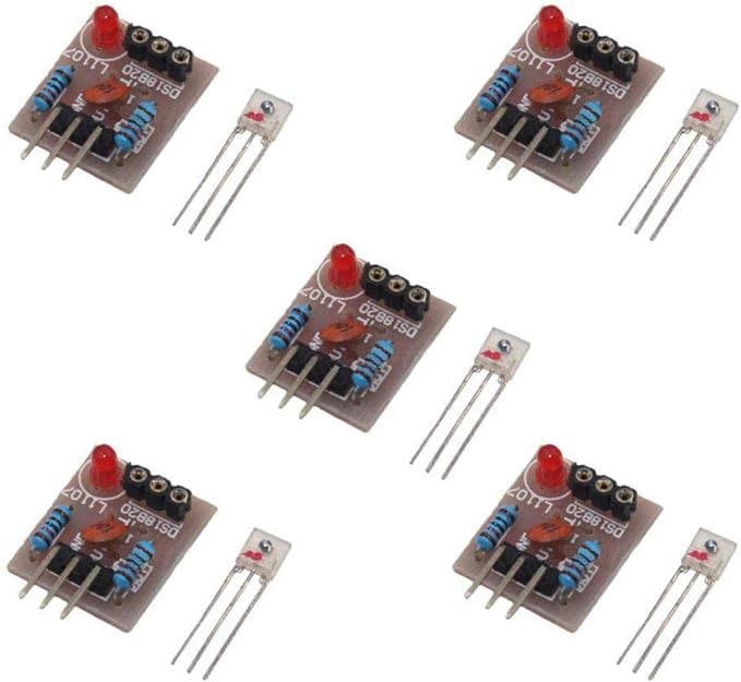

Good day to all. As background info, I previously posted about a personal project involving multiple vertical and horizonal lasers I have been working on for awhile. The moderators closed the earlier discussion due to no activity in responses, which is why I created this new one. Basically, my project involves multiple lasers, where the beams intersect each other and if something blocks it, the programming turns on a light. I'm using a green laser 532nm 10mv 5v and for the sensors, Non-Modulator Tube Laser Receiver Detection Module Relay Switch. The device has 9 horizonal lasers and 8 vertical lasers. In the garage, it works 100% all the time and accurately. It's when I set it up outside, the sun (UV rays?) deteriorates the connectivity from occurring. I've tried putting a canopy over the structure but still have connectivity issues. Move it back inside and all is good. Would a sensor with a potentiometer allow better connectivity where there is sunshine? Both the lasers and sensors are enclosed in a wood frame, so only the beam is exposed to sunlight. Below are pics of the lasers, sensors and structure. The distance horizontally between the laser and sensor is approx 8'. The distance vertically is approximately 7'. Any laser sensor suggestions to try? When the device is outside, if I block the beam anywhere in the middle, the programming doesn't show the beam being disrupted. If I cover the hole completely with my hand, the beam disconnection registers. I also do not need to see the laser beam in the sunlight. I need to have connectivity only. There was a post I saw on another inquiry suggesting a PLL chip. How would this work?

Could be any wavelength that the detector receives. To avoid this, most people would modulate the laser and/or use narrow 532 nm bandpass filters in front of the receiver.

Your sensor is very sensitive to infrared, so it's not surprising that you have trouble in the sun. It also has a very wide beam angle that make things worse.
You might try connecting a 470 ohm resistor between Vcc and OUT, this will decrease the overall sensitivity. If that does not work then you need to look for a more appropriate sensor and/or LASER-sensor combination.
