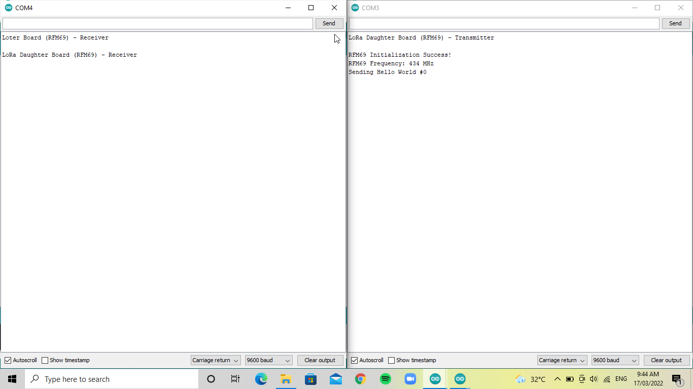

Hello. I'm working on RFM69 connected to an Arduino Uno. Currently, I was able to initialize the RFM69 using the a code I modified from the internet. However, my Receiver part always encounters error. It doesn't sometimes proceed and sometimes got stuck in the initialization loop. Yesterday, my Transmitter managed to work properly but today, sometimes I also observed same problem with my Receiver.

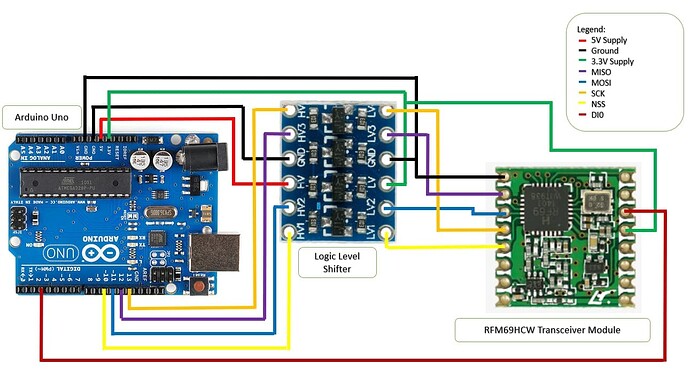

Here's my wiring.

Here's a screenshot of the result
Taken yesterday: Mar 16
Taken today: Mar 17
I hope someone could help me with. Thank you in advance.

two thoughts
1 the level shifters are too slow for spi [ i use simple resistive divider]
2 the 3.3v supply from the uno is not able to run a rfm69hw
i run a ldo 3,3v reg [ with suitable caps] from the 5v rail

Currently, the 3.3V of the RFM69 comes from a regulator that outputs 3.3V and 150 mA Imax. My assumption is that the problem comes from the level shifters huhuhu. So youre suggesting to use a resistive divider instead?

Just a bit of clarification, which RFM69 module do you have. Is it the HCW variant shown in the fritzing diagram in post #1, or another variant.
Hello @markd833 I'm using RFM69HCW module.

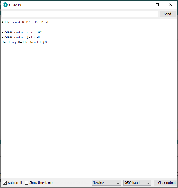

I am reporting the same issue. I have a nano 33 IoT board connected to a Sparkfun RFM69HCW board - so no level shifter - all running at 3.3V.
It was working perfectly until a few days ago it started giving the same error as above. Tested multiple radio boards. Same result.
I didn't install any new board package. But something obviously changed.

I have a system working that's using the RadioHead library version 1.121 (as listed in the library.properties file. I used the rf69_reliable_datagram_client/server.pde sketches but have modified them for my own application.
I found that I had several different libraries on my system. I quarantined the libraries, testing one by one until I found the version that worked. I also tested each one with various
BSP versions.
Here are notes from my sketch header:
Radiohead Library checksum:
  • 193 files
  • 104 folders
  • Size on disk: 1.92 MB (2,015,232 bytes)
Arduino Board Package:
  • Arduino SAMD21 M0
  • 1.8.11
I'm using the Sparkfun RFM69 Breakout (915MHz).
Regarding the antenna, the length for 915Mhz should be 74mm.
Hope this helps.
