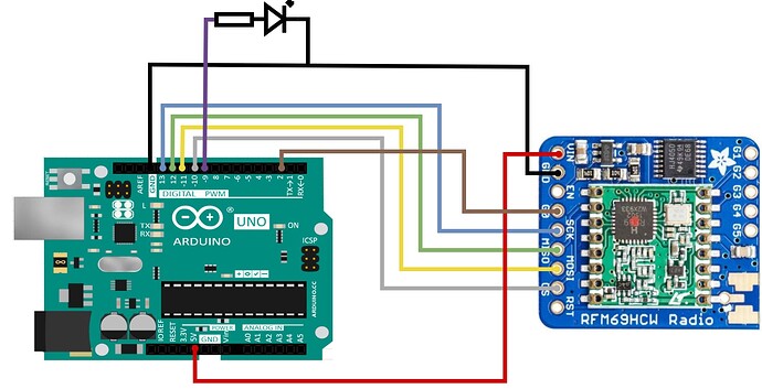

Hello,
I am trying to use LowPowerLab's RFM69 library, but I can't get past the initialization. I have gotten RadioHead examples to work, so the problem shouldn't be soldering or the antenna.
I have an Adafruit RFM69HCW module connected to an Arduino Uno like so:
The Adafruit breakout board has logic level converters on all the pins, so they're connected directly to the Uno.
This is the code I'm running:

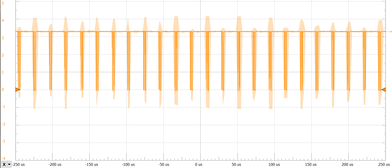

Now what happens is that reading the REG_VERSION register should have returned 42 had there been an SPI connection, according to the RadioHead library's init function. It returns 0.
I scoped the spi pins on the RFM69HCW and discovered that the MISO pin gave a very small signal:
compared to when I did the same using the RadioHead library:
The MOSI pin looked like this:
SCK:
NSS:
Any idea what could be the problem? Help would be very much appreciated :slight_smile:
