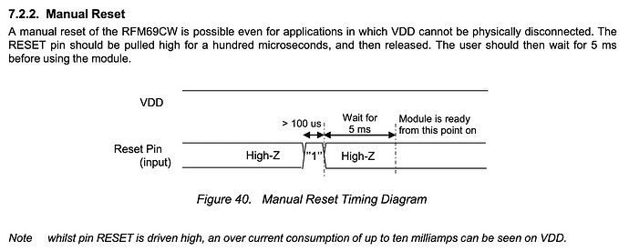

Hi - not sure if you've resolved this yet, but one potential issue is the reset pin. I have a suspicion that the RESET pin is incorrectly documented by Adafruit for the RFM69HCW. If you look in section 7.2.2 Manual Reset in the datasheet for the RFM69HCW, you'll see that it is pulled LOW when it is active and you pulse it HIGH for >100 us to reset.
However, for the RFM95, the polarity of the reset pin is the opposite. It's section 7.2.2 Manual Reset again:
You can also see the differing pull up/down behaviour of the two modules. This would explain why your SPI transfer is failing - the RFM module is in reset.
If your section for reset, try changing the polarity of the reset as so:
// Reset the RFM69 module
digitalWrite(RFM69_RST, HIGH);
delay(100);
digitalWrite(RFM69_RST, LOW);
delay(100);
I don't use Arduino but came across this thread while looking at RFM module - hope this helps! This module has been out for a long time with Adafruit, so I'm a little surprised this hasn't been raised.
Note that you do not need to drive the reset pin the RFM module in normal operation at power on:
Again, polarity is inverted for the RFM95.
