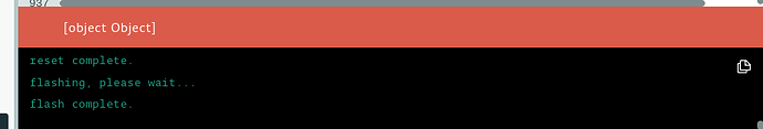

That helped, thanks! We are now encountering a different error,
(Attachment Screen recording 2023-10-26 10.48.20 AM.webm is missing)
The code is now giving us the error (object, Object)
The error occurs when we are trying to upload the code to Arduino Nano and it begins flashing. half way through the flashing it gives the error then stops.

  7. Click the "OK" button.
After that, you should be able to upload the sketch without encountering that error.
Please let me know if you have any questions or problems while following those instructions.
