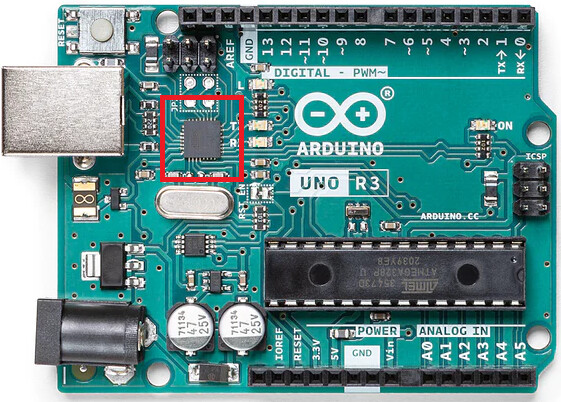

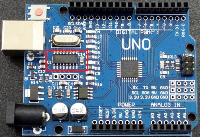

One of the things you can check is what chip your Arduino uses to communicate with the USB. Arduino clones use to have a CH340 chip
instead of the original 16U2
If so, you might need to install the CH340 driver in order for your PC to recognize the board.
