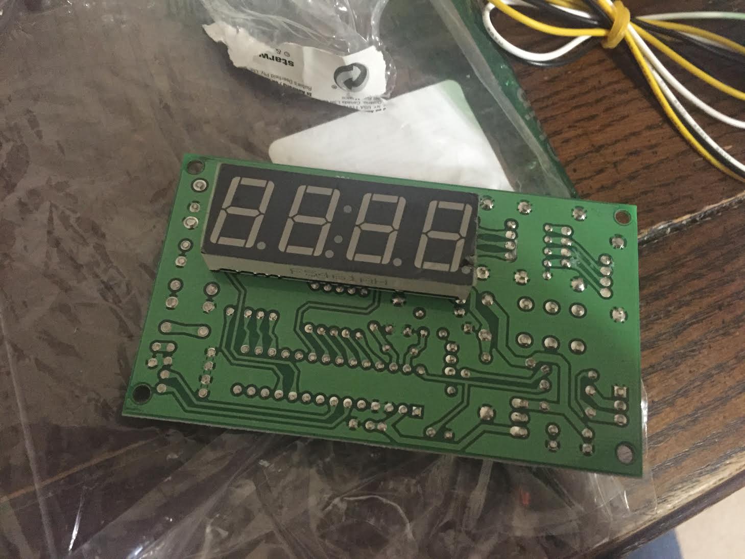

The seller also included a separate board with a Coin Counter (pictured below) along with 4 USB cables, but did not provide instruction on how to connect that to the Coin Acceptor, here's a link to pics of the board: http://i.imgur.com/gkeDTiD.jpg http://i.imgur.com/8VamE10.jpg
The board also came with 2 cables, with wires having open ends. The smaller one is pictured plugged into the board (and has 2 wires) and the larger one is directly above the board in the picture (and has 3 wires).

The additional board you have received (with 4 USB sockets) appears to be the “time control board” on the vendor’s home page http://www.coin-selector.com/ . It is an extra and almost certainly not essential to the functioning of the coin selector.
