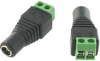

Hi
As I want to make this a standalone system, I will have to use a common power supply.
Attached is my circuit. I feel this should be fine but wanted to double check whether 12 V DC, 2 A direct to Arduino shouldn't damage the board.
If there is a better way to power all the parts, please let me know.
Thanks.
nileshrg:
You can run the Arduino on 12V. It would be slightly better to use the DC jack instead of the Vin pin. It has a reverse-voltage-protection diode which not only protects the Arduino if you get the voltage reversed but it also drops the voltage a little bit making it slightly closer to the ideal 7V instead of the recommended maximum of 12V. A more efficient solution would be a 5V buck converter connected to the +5V line.
DO NOT connect your servos directly to 12V. Typically they are designed for 4.5-6V. They can also draw as much as 1 Amp each. If you use a 5V buck converter for the Arduino and it can handle 24 Watts you can use it to also power the servos.

I would use the DC jack but since I have to share the GND with the coin acceptor I split the 12V DC using a converter. I have attached the pic.
How do I power the Arduino and coin acceptor from a single power supply of 12V DC ?
