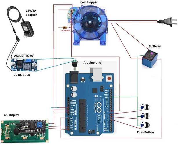

this is the diagram i am using
One thing that jumped out at me: an Arduino output pin won't source anywhere near enough current to energize a relay coil. At least, it probably won't do it twice... And if that didn't burn out the output, the reverse EMF from the coil when the magnetic field collapsed quite likely finished the job.
On your next Uno, you'll need a transistor with a base/gate resistor (depending on whether you go BJT or MOSFET) to drive the relay coil, and a reverse biased diode across the relay coil to absorb the reverse EMF.
…or a relay module with a logic level control pin, and voltage supplied directly from the supply rail.

During startup the status of the output pins is not defined yet..
One resistor may do the trick...

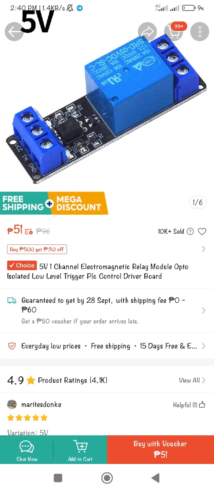

i use a non inverted relay module 5v
what kind of resistor and where to attach it?
this relay
Looks like the relay module might be opto driven.
Please supply the relay module specs.
Not sure what you mean by non-inverted relay. Most will have c/o contacts to suit whatever logic you feed in.

what possible kind of mosfet i use and resistor?in the diagram i use a 10k ohm resistor connected from the pin of the coin sensor and the other side to the positive 5v
You do not need a mosfet. Your relay module already has a driver.
Try to add a 1k resistor from A0 to ground. That should hold the input low during startup.
the 10k ohm resistor from sensor pin to 5v?is that ok?
