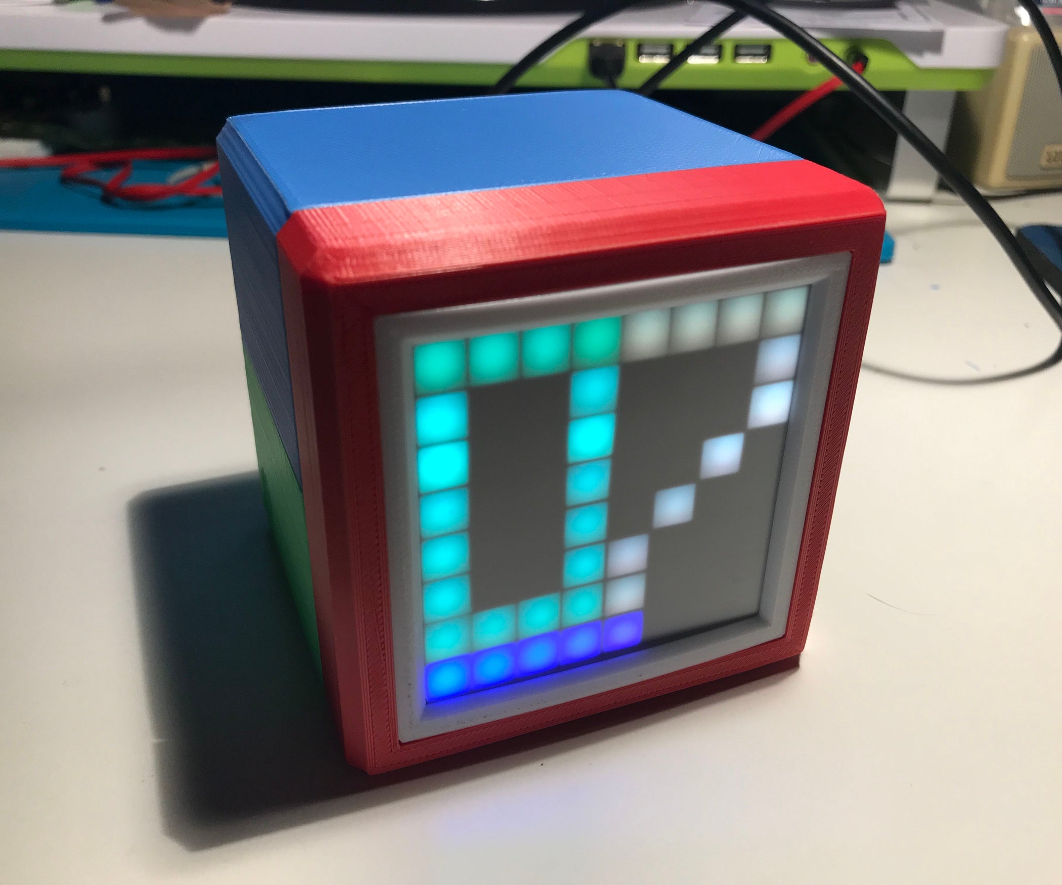

I am trying to build the following project from instructables.com.
I have the entire project completed except the programming of the icDunio module with the provided code https://cdn.instructables.com/ORIG/F4F/X143/JI0JJ0QA/F4FX143JI0JJ0QA.ino
I have tried changing the Colorduino Libraries , as the code calls ColorFill, this was an addition to V2.3 of the library, I have tried 2.4 and 2.7 without any luck. but dont have any access to any other versions except earlier issues, V1 and 1.1
Any Help appreciated.
