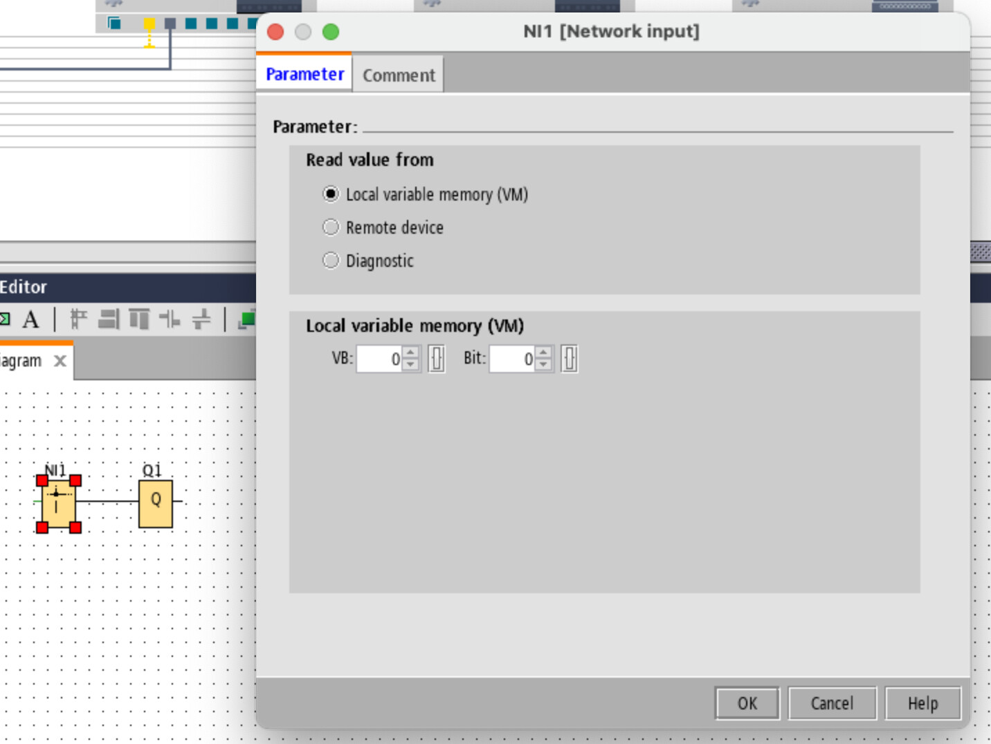

I am new here to the forum and to arduino.
I would like to learn more about communication between arduino and Siemens logo 8 via modbus tcp ip.
Does anyone have a simple example of this?
I would like to learn to switch a marker flag high or low.

I used a program fl prog to create arduino code. With this I was able to make a working sketch.
but lost this one. And searching a simple sketch as an example to learn from. Sending a coil high or low.
At eps8266modbus I found this example.
But it is not clear to me how I can indicate these with the addresses to my Siemend Logo.
Modbus-Arduino Example - Test Led (Modbus IP ESP8266)
Control a Led on GPIO0 pin using Write Single Coil Modbus Function
Original library
Copyright by André Sarmento Barbosa
http://github.com/andresarmento/modbus-arduino
Current version
(c)2017 Alexander Emelianov (a.m.emelianov@gmail.com)
https://github.com/emelianov/modbus-esp8266

I found how to make connection between my Logo and an ESP8266.
It serialprints a message and when i disconnect the ethernetcable of the Logo the message stops.
