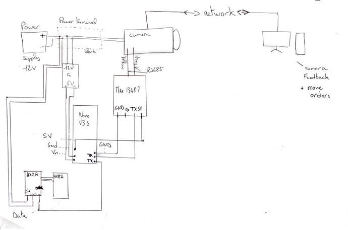

hi koepel, thank you for your involvement.
i use the library AX12A. it allow to control this servos without special shield (TX pin to data ax12a).
and here is a schematic, i hope it is readable for you.
i'm a newbie so i can't post files. i let you a wetransfer link for the PDF
Edit: i missed to draw ground between max13487 and the camera (ground power
supply->max13487)
i've done your test without servos and it's the same, always receive "0000000"
and i receive between 1 and 3 frames..

Your WeTransfer picture:
According to the schematic of the Arduino Nano, the VIN goes into a LM1117. There is a voltage drop of about 1V.
You can try to power the Nano with 5V applied to its 5V pin.
Splitting a serial port for two different things is okay. As long as the baudrate is the same.
Things that got my attention:
  • The Library does not work with every baudrate ? According to the introducation page. That seems very unreliable ! And the reason is unknown ?
  • The TX signal for the data for the servo motors is only valid with a good GND. That route for the GND from the Nano to the Servo motor seems to be very long.
  • The array size for byteReceived[7] is only seven. That scares me, can you make it 20 ?

It could still be the servo motors themself. Perhaps a lot of noise by the servo motors got into the serial lines. Perhaps there is a breadboard with bad contacts. Perhaps your wires are not well organized.
Here is a tutorial: https://forum.arduino.cc/t/common-ground-and-why-you-need-one/626215.
A star-grounding prevents a lot of problems, but sensors should not use the star-ground, and it has a few disadvantages.
Do you know how ground works ?
Let's say that the GND pin of the Arduino is the "real" ground. When connecting a wire of 1 meter to it, then there is no ground at the end of that wire. Because that wire is an antenna.
The current that flows into the servo motor returns via the ground wire to the power supply. That current through the ground wire can introduce a lot of noise in the whole circuit.
But all GND of every devices are now directly linked to the nano's GND, linked itself to the camera by the power terminal block :confused:
Also, i found this library who seems better reliable than the old one. But by using this file, i cannot operate the serial communication between RS485 converter and nano
That library is 10 years old, a lot of things have changed in the Arduino world in the last 10 years.
It is hard for me to say something useful about the ground or how that noise enters the serial signal without seeing and touching it. I'm not even sure that it is noise.
The RS-485 is mostly used with a ground signal to prevent unbalanced signals.
There could be so many things going on, I'm sorry, but I don't know what more I can say.
A few weeks ago, someone had a lot of trouble with an Arduino and electrical trains and cars. Such a circuit needs to build with grounding in mind.
