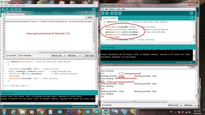

Thanks Mostafa. I found your other posts regarding SUART and it perfectly works. But now I have other issue ! when I try with a test prog it works well but when I add SUART sections to my main sketch, I can't see them correctly in my second terminal's serial monitor. Could you please, help me get rid of this issue?

You are mixing up two data types viz., byte and int without proper casting. Please, read this post and see how data can get lost if proper casting is not made. In the meantine, plase remember the following rules while ORing or ANDing data of different sizes:
1. You have: int bigNum anf int bigNum1
2. You have byte a, b,c, d, A, B, C, D
3. You are doing:
(1) bigNum = a; //fine a will fit into bigNum
**(2)**bigNum = bigNum << 8 | b; Are you doing right?
Say, bigNum = 0x1234 anf b= 0x67. You are shifting it (bigNum) to left by 8-bit, and you are expecting 123400; when, it is ORed with b, you expect 123467 which is 24-bit. I think that you will come up with 3467. How and why?
Remember: Assume you are using UNO
Arduino UNO uses 16-bit 'processing buffer' for data manipulation. If you get a result that comes up as greater than 16-bit after manipulation (as you have done above), the lower 16-bit of the result will be kept; all the upper bits of the result will get lost. The solution is to tell the UNO (aka casting) to expand the processing buffer size.
int32_t bigNum = (int32_t)bigNum <<8 | b; //now bigNum holds: 00123467
Hope, you have got the point!
I've read your post about converting and sizing data and I've got your point.
I tried this method. The thing is the values I received via I2C and I transferred to the the same serial terminal are good, but when I transfer them via "SoftwareSerial" (Bluetooth medium), the data are confused. I appreciate,If you take a look at the screenshot!
Thanks

@Alidan
1. Look at the slight change that I have on your sender codes:
#include <SoftwareSerial.h>

    //mySerial.write((int32_t)bigNum);    // Read received byte
    //.write() method accepts 8-bit data (1-byte)
    mySerial.print(bigNum); //  8-byte
    Serial.println(bigNum);//(int32_t)bigNum);

Thanks. But skecth got stock while compiling. IDE returns couple of errors regarding the size!
sketch_mar12a.ino:42:11: error: conflicting declaration 'int64_t bigNum'
sketch_mar12a.ino:41:11: error: 'bigNum' has a previous declaration as 'int32_t bigNum'
sketch_mar12a.ino:46:11: error: conflicting declaration 'int64_t bigNum1'
sketch_mar12a.ino:45:11: error: 'bigNum1' has a previous declaration as 'int32_t bigNum1'
Error compiling.
I tried to transfer values in to termperoray variables but it gives back another issue:
D:\arduino-1.6.3\hardware\arduino\avr\cores\arduino/Print.h:78:12: note: size_t Print::println(long unsigned int, int)
     size_t println(unsigned long, int = DEC);
D:\arduino-1.6.3\hardware\arduino\avr\cores\arduino/Print.h:79:12: note: size_t Print::println(double, int)
     size_t println(double, int = 2);
Error compiling.
Thanks your attention an your helps
Please, look at the data size and the number of bits you are shifting. And accordingly, do cast to retain the useful part of the operand/result. For example:
/*-----( Declare Constants and Pin Numbers )-----*/
#define SSerialRX 10
#define SSerialTX 11
#define Pin13LED  13
/*-----( Declare objects )-----*/
SoftwareSerial mySerial(SSerialRX, SSerialTX); // RX, TX
/*-----( Declare Variables )-----*/
int32_t bigNum = 0;
int32_t bigNum1 = 0;
byte a, b, c, d, E, F, G, H;
  Wire.begin();        // join i2c bus (address optional for master)
  Serial.begin(9600);  // start serial for output
  pinMode(Pin13LED, OUTPUT);
  pinMode(Pin13LED, LOW);   //Led is OFF
  // Start the software serial port, to another device
  mySerial.begin(9600);   // set the data rate
}//--(end setup )---
  Wire.requestFrom(8, 8);  //requesting b-byte from I2C Slave
  a = Wire.read();  //8-bit
  b = Wire.read();
  c = Wire.read();
  d = Wire.read();
  E = Wire.read();
  F = Wire.read();
  G = Wire.read();
  H = Wire.read();
  bigNum = (int32_t)a;        //ask for 32-bit 'temporary processing buffer)
  bigNum = (int32_t)(bigNum << 8) | (int64_t)b;
  bigNum = (bigNum << 8) | (int32_t)c;
  bigNum = (bigNum << 8) | (int32_t)d;
  bigNum1 = (int32_t)E;
  bigNum1 = (int32_t)(bigNum1 << 8) | (int32_t)F;
  bigNum1 = (bigNum1 << 8) | (int32_t)G;
  bigNum1 = (bigNum1 << 8) | (int32_t)H;
  Serial.print("Reading_scale#1: ");
  Serial.print("gr");
  Serial.print(" \t\t");
  Serial.print("Reading_scale#2: ");
  Serial.print(bigNum1);
  Serial.print("gr");
  Serial.print("\n");
  digitalWrite(Pin13LED, HIGH);  // Show activity
  if (mySerial.available())  //Look for data from other Arduino
    Serial.println("Data sending");    // Show on Serial Monitor
    delay(10);
    digitalWrite(Pin13LED, LOW);  // Show activity
  delay(100);
