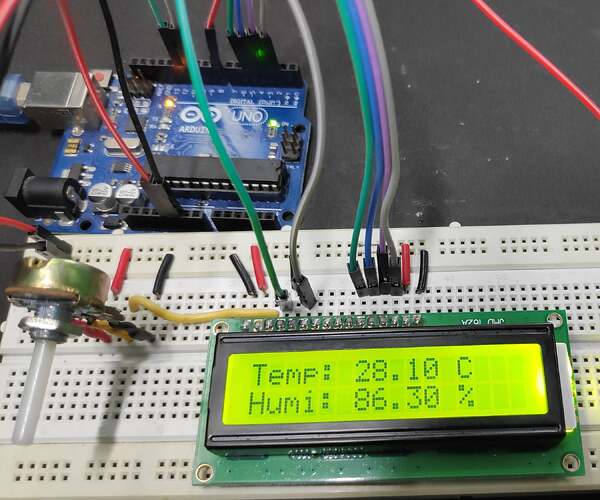

Hey all,
I am trying to upload my first sketch, No luck.
I feel like this is a library error? I have added a few different DHT11 libraries to no avail.
Any assistance would be greatly appreciated.
The Arduino board I am using is: ELEGOO MEGA2560 R3.
I followed this guide:
Getting this error:
In file included from /Users/Documents/Arduino/libraries/DHT_sensor_library/DHT_U.cpp:15:0:
/Users/Documents/Arduino/libraries/DHT_sensor_library/DHT_U.h:36:10: fatal error: Adafruit_Sensor.h: No such file or directory
 #include <Adafruit_Sensor.h>
compilation terminated.
exit status 1
Compilation error: exit status 1

#include <LiquidCrystal.h>
#include "DHT.h"
#define DHTPin 8
LiquidCrystal lcd(12,11,5,4,3,2);
DHT dht;</liquidcrystal.h></p><p>void setup()
  dht.setup(DHTPin);
  lcd.begin(16,2);
  float temp = dht.getTemperature();
 float humi = dht.getHumidity();
 lcd.setCursor(0,0);
 lcd.print("Temp: ");
 lcd.print(temp);
 lcd.print(" C");
 lcd.setCursor(0,1);
 lcd.print("Humi: ");
 lcd.print(humi);
 lcd.print(" %");
 delay(2000);
}</p>

/private/var/folders/cq/mwsy0lxj79bdfh1zqpw7hjgr0000gn/T/.arduinoIDE-unsaved20241128-8422-rfodz.q9mj1q/sketch_dec28a/sketch_dec28a.ino:5:5: error: no matching function for call to 'DHT::DHT()'
In file included from /private/var/folders/cq/mwsy0lxj79bdfh1zqpw7hjgr0000gn/T/.arduinoIDE-unsaved20241128-8422-rfodz.q9mj1q/sketch_dec28a/sketch_dec28a.ino:2:0:
/Users/Documents/Arduino/libraries/DHT_kxn/DHT.h:65:3: note: candidate: DHT::DHT(uint8_t, uint8_t, uint8_t)
   DHT(uint8_t pin, uint8_t type, uint8_t count = 6);
/Users/Documents/Arduino/libraries/DHT_kxn/DHT.h:65:3: note:   candidate expects 3 arguments, 0 provided
/Users/Documents/Arduino/libraries/DHT_kxn/DHT.h:63:7: note: candidate: constexpr DHT::DHT(const DHT&)
 class DHT {
/Users/Documents/Arduino/libraries/DHT_kxn/DHT.h:63:7: note:   candidate expects 1 argument, 0 provided
/Users/Documents/Arduino/libraries/DHT_kxn/DHT.h:63:7: note: candidate: constexpr DHT::DHT(DHT&&)
/private/var/folders/cq/mwsy0lxj79bdfh1zqpw7hjgr0000gn/T/.arduinoIDE-unsaved20241128-8422-rfodz.q9mj1q/sketch_dec28a/sketch_dec28a.ino:5:9: error: expected unqualified-id before '<' token
/private/var/folders/cq/mwsy0lxj79bdfh1zqpw7hjgr0000gn/T/.arduinoIDE-unsaved20241128-8422-rfodz.q9mj1q/sketch_dec28a/sketch_dec28a.ino: In function 'void loop()':
/private/var/folders/cq/mwsy0lxj79bdfh1zqpw7hjgr0000gn/T/.arduinoIDE-unsaved20241128-8422-rfodz.q9mj1q/sketch_dec28a/sketch_dec28a.ino:12:20: error: 'class DHT' has no member named 'getTemperature'; did you mean 'readTemperature'?
                    readTemperature
/private/var/folders/cq/mwsy0lxj79bdfh1zqpw7hjgr0000gn/T/.arduinoIDE-unsaved20241128-8422-rfodz.q9mj1q/sketch_dec28a/sketch_dec28a.ino:13:19: error: 'class DHT' has no member named 'getHumidity'; did you mean 'readHumidity'?
                   readHumidity
/private/var/folders/cq/mwsy0lxj79bdfh1zqpw7hjgr0000gn/T/.arduinoIDE-unsaved20241128-8422-rfodz.q9mj1q/sketch_dec28a/sketch_dec28a.ino: At global scope:
/private/var/folders/cq/mwsy0lxj79bdfh1zqpw7hjgr0000gn/T/.arduinoIDE-unsaved20241128-8422-rfodz.q9mj1q/sketch_dec28a/sketch_dec28a.ino:23:2: error: expected unqualified-id before '<' token
 }</p>
Multiple libraries were found for "DHT.h"
  Used: /Users/Documents/Arduino/libraries/DHT_kxn
  Not used: /Users/Documents/Arduino/libraries/DHT_sensor_library
Multiple libraries were found for "LiquidCrystal.h"
  Used: /Users/Documents/Arduino/libraries/LiquidCrystal
  Not used: /Users/Library/Arduino15/libraries/LiquidCrystal
exit status 1
Compilation error: no matching function for call to 'DHT::DHT()'
That is the first error. The code was badly copied and pasted, fix all of those errors then fix the DHT constructor, then install the DHT library correctly. Now compile.
No need to re-install, won't change anything. Fix problem noted in post #1, and #5, fix problem noted in post #9
Because you didn't fix a lot of typos, mentioned by @sonofcy in post #9
