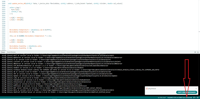

Compile fails with ESP32S, weird message: "ping timeout"
Trying to compile an ESP32 project, this is the error I get:
Ping timeout???
Any ideas???

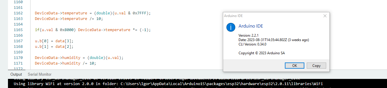

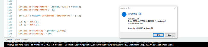

This is the version of the IDE:

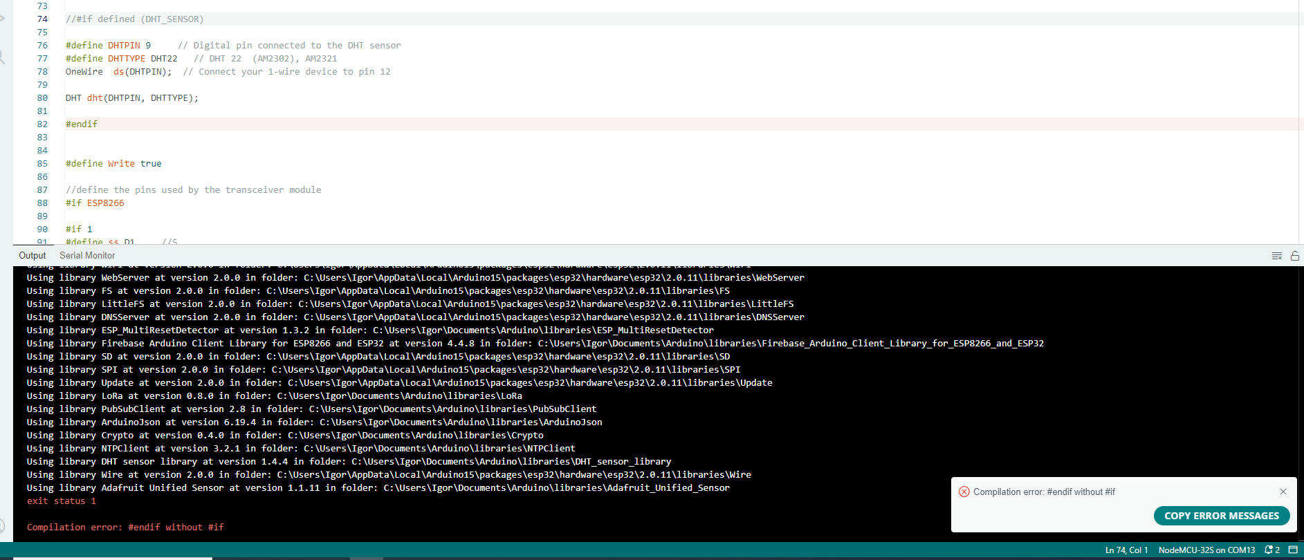

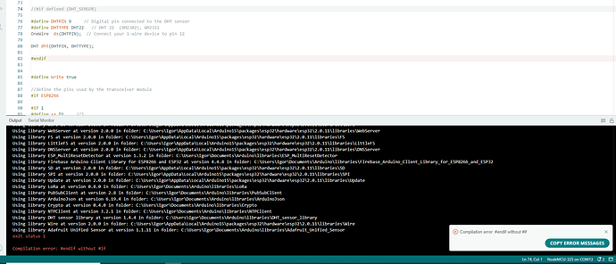

Just found out, that if I copy the error and paste it into notepad, it shows some compilation errors. But the error is with OneWire?
c:\Users\Igor\Documents\Arduino\libraries\OneWire\OneWire.cpp: In member function 'uint8_t OneWire::reset()':
c:\Users\Igor\Documents\Arduino\libraries\OneWire\OneWire.cpp:167:24: error: unused variable 'reg' [-Werror=unused-variable]
volatile IO_REG_TYPE *reg IO_REG_BASE_ATTR = baseReg;
c:\Users\Igor\Documents\Arduino\libraries\OneWire\OneWire.cpp: In member function 'void OneWire::write_bit(uint8_t)':
c:\Users\Igor\Documents\Arduino\libraries\OneWire\OneWire.cpp:201:24: error: unused variable 'reg' [-Werror=unused-variable]
c:\Users\Igor\Documents\Arduino\libraries\OneWire\OneWire.cpp: In member function 'uint8_t OneWire::read_bit()':
c:\Users\Igor\Documents\Arduino\libraries\OneWire\OneWire.cpp:229:24: error: unused variable 'reg' [-Werror=unused-variable]
cc1plus.exe: some warnings being treated as errors

Hi @aiggya are you still experiencing that "ping timeout" error notification while compiling?
If so, I'm going to ask you to post some additional information that might help us to identify the problem.
Please do this:

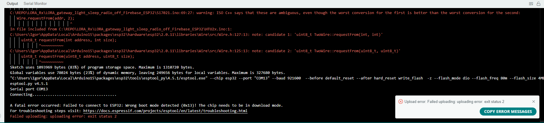

Right now I can no longer program ESP32S, says:
I can no longer recreate it?
No, it is true at the time it was not connected to computer, but this picture was for compile error. Later there is a picture showing connection on COM13. So this is where I already knew I have issues programming.
Today I managed to reprogram, but I still do not know why it worked, all previous and subsequent trys failed.
