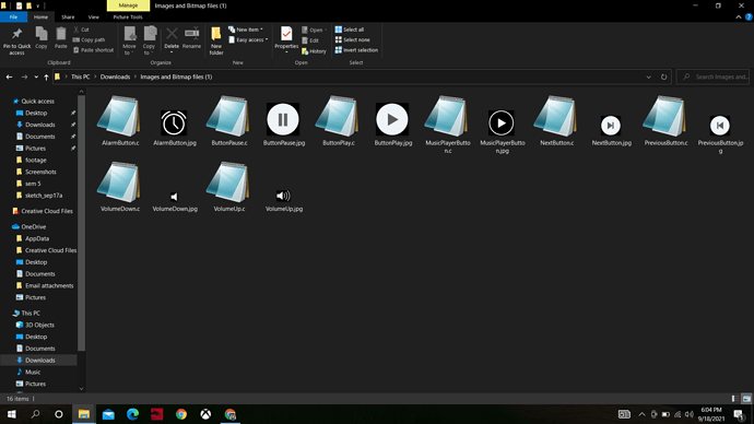

Conflicting declaration 'const short unsigned int AlarmButton [4160]'
Hi sir, I am a beginner at this Arduino programming.
conflicting declaration 'const short unsigned int AlarmButton [4160]'
the code is below...:-
#include <avr/pgmspace.h>
const unsigned short AlarmButton[0x1040] PROGMEM ={

When I compile it shows,
this project, I copied from

This code is basically an image that was converted into a bitmap format. So it has more coma's.
Did you download the code and the image/bitmap files from the webpage correctly? The image/bitmap files go into the same folder as the sketch, and will get compiled along with the sketch. AlarmButton is declared as an external variable in the sketch, and is defined in the AlarmButton.c file, apparently you are defining AlarmButton a 2nd time somewhere else.
yes sir, I have downloaded the bitmap images along with a code and I just copy the code sir...that's it...is that I need to do anything else rather than copying the bitmap coding..?
You have put all the image files into .ino files, instead of the original .c files. The sketch declares all the image files as "extern", meaning the images are in separate files, but the compiler is combining the .ino files with the sketch and compiling those as a single file. Comment out the lines declaring the images as extern and it should compile OK, or go back to using the original image files with the .c extension.
Fine in c++
Sir, so do you mean I have to change this all c files into .ino then drag the file into the the recent file, then it will compile is it sir...?
From the picture you posted, it appears the files have already been changed to .ino, files, they should have been left as .c files, but you should be able to go into the sketch file and comment out the following lines and have the code compile correctly:

Now I don't understand what you are doing, the first picture you posted had multiple files in the sketch directly, the last picture shows only the sketch file.
The .c files for the images are suppose to be placed in the same folder as the sketch, where the compiler will be able to find them, and they are suppose to have the .c file extension.
