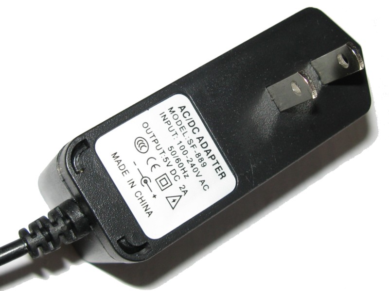

According to the following Arduino Page I should be using a 9V power supply: http://playground.arduino.cc/Learning/WhatAdapter
However, a lot of projects I see use no more than 5V power supplies. Would using the 9V power supply on a project that requires 5V, or less cause a problem?
You need to get to 5V somehow for the 328P/1284P/2560 microcontroller.
You can regulate 7.5V/9V/12V down to 5V with the onboard regulator.
You can apply 5V directly thru the USB connector.
You can apply 5V directly thru the 5V power header.
You can have a standalone design and not even have a 5V regulator on the board, with 5V coming from a regulated wallwart, for example
http://www.dipmicro.com/store/DCA-0520
I use 5V wallwarts all the time to power projects.
