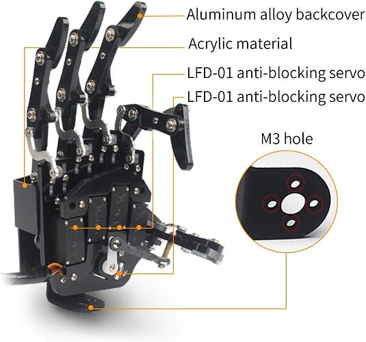

Servo motors would seem a better choice than stepper motors for this project.
What's making You uncertain?
The "hand robots" that I have been seeing for sale or DIY use servo motors (180 degree rotation) rather than stepper motors (continuous/360 degree rotation).

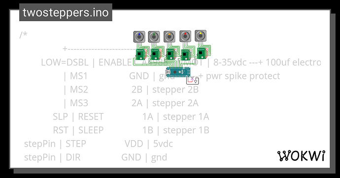

Compare servo (above) with five bipolar stepper motors with A4988 motor driver
OP said 28BYJ-48 steppers with ULN boards. That's four pins per stepper.
Not enough pins on most boards, except for a Mega.
An Uno has no problems driving 100+ BYJ-48 steppers at max speed, but the problem is pincount.
Servo motors and maybe a 16-channel PCA9685 servo board seems a good solution.
