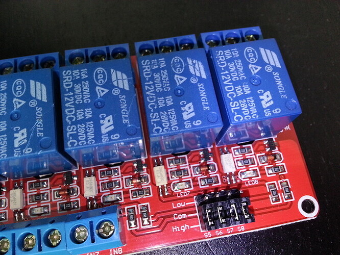

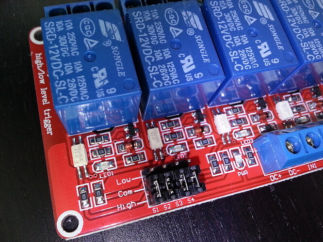

Does anyone know the correct way to connect this to my Arduino?
Not sure what make it is. It has 2 sets of jumpers on each side of the board which make it a bit confusing.
The Middle terminals are marked:
DC+ DC- IN1 IN2 IN 3 IN4 IN5 IN6 IN7 IN8
I understand the middle connections it's the Jumpers that have me a little confused.??
Please see attached Photos
with this jumpers, you can choose if the relays should trigger when high or when low
Low-level triggered will allow the current to go through the power line when the control signal is below a certain voltage.
High-level triggered will allow the current to go through the power line when the control signal is above a certain voltage.

Ah OK, thanks for making that clear for me, so just to recap, if I have my Arduino Digital pins set to HIGH I would choose the Hight setting on the Relay module Jumper correct?
