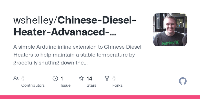

I came across this project:
Which uses an arduino to control the heater similar to the way a thermostat would by reading the built in temperature sensor in the controller and issuing a shutdown command when the set point temperature is reached and maintained for a certain period of time and starting it up again when the temperature drops too low. Which seems like it would solve the problem. My issue is though that the temperature sensor in the controller isn't really that great. It seems relatively inaccurate compared to my wall thermostat and the range in the readings it gives seem off. It seems to consistently read too high and generally lacks a lot of the built in temperature differential stuff that modern digital thermostats have built in. The wall thermostat also has basic scheduling features I wouldn't mind taking advantage of.

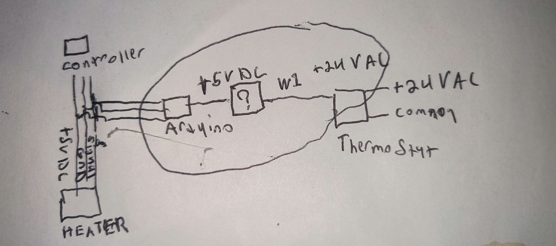

I planned to base my project off the sketch I posted above and modify it so that it reads a pin connected to the wall thermostat and acts based on whether that's high or low rather than reading the temperature from the controller. That part seems pretty straightforward what I'm not sure about is the best way to read input from the thermostat. My first thought would be to use a 24v transformer and a relay of some kind that switches between 24v AC and 5v DC but I have no idea if such a thing exists. It also seems like there's probably a more simple and efficient way and it would be nice if there was a way I could somehow avoid having a separate 24v transformer as the thermostat is battery powered and the arduino will be powered by the 5v from the heater controller so if I can it would be nice to avoid having to use something that needs external power.

This is a quick schematic I guess. Sorry if it's a bit unclear. It's that circled area I'm most interested in. How to read the 24vac signal from the w1 terminal coming from the thermostat with the arduino. Just whether it's high or low.

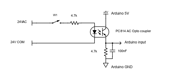

How about an AC opto coupler?
https://media.digikey.com/pdf/Data%20Sheets/Sharp%20PDFs/PC814X%20Series.pdf
Scheme-it-export-New-Project-2024-10-13-00-44
Thank you. This looks like what I had in mind I think. Though I was doing some more thinking about it and right now the thermostat is hooked up to a trailer furnace switching 12v DC power. It's not made for it but it seems to work fine. I'm wondering if I could use the 12v power going to the heater and switch that between r and w1 instead. In that case I would just need a step down voltage regulator I think and would eliminate the need to deal with any 24vac.

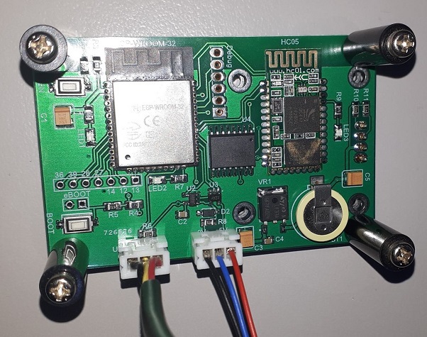

The controller has 3 wires a +5vdc, ground and a signal wire that sends encoded serial data between the ECU and the controller. There has been fairly extensive work done already on reading and writing data on that serial line with an arduino.

I swapped my ECU and controller for a different one. The link I posted in my comment earlier has the best information about the ECU currently in my heater. This one:
It's fairly detailed and is probably the best source of information lacking an official data sheet. According to the info in that link, the ECUs the author examined had their part numbers obfuscated so their data sheets could not be looked up.
