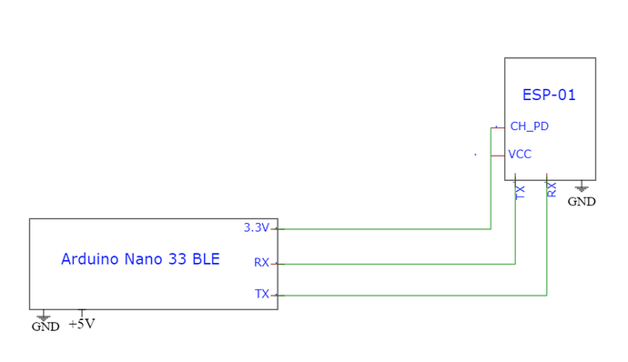

Im making a project about a fire detection system using arduino nano 33 ble sense with an esp01. The system is supposed to send an email to the user in case of a fire. I'm facing a problem with the esp01, every time i'm trying to upload the sketch i would get this error: "A fatal esptool.py error occurred: Failed to connect to ESP8266: Timed out waiting for packet header"
This is the circuit that i'm following:
And this is my code:

Any suggestions on what could be wrong here?
Disconnect the Tx & Rx!
put the SerialPassthrough example into the Nano BLE. set it to use 115200 baud
but did you put the esp8266 into bootloader mode? (io 0 to gnd at boot)
I actually haven't. I will check that.
thanks a lot it worked. For the wifi connection it connects and disconnects after approximately 1 min , any idea why that happens? I'm using the same code that I posted
