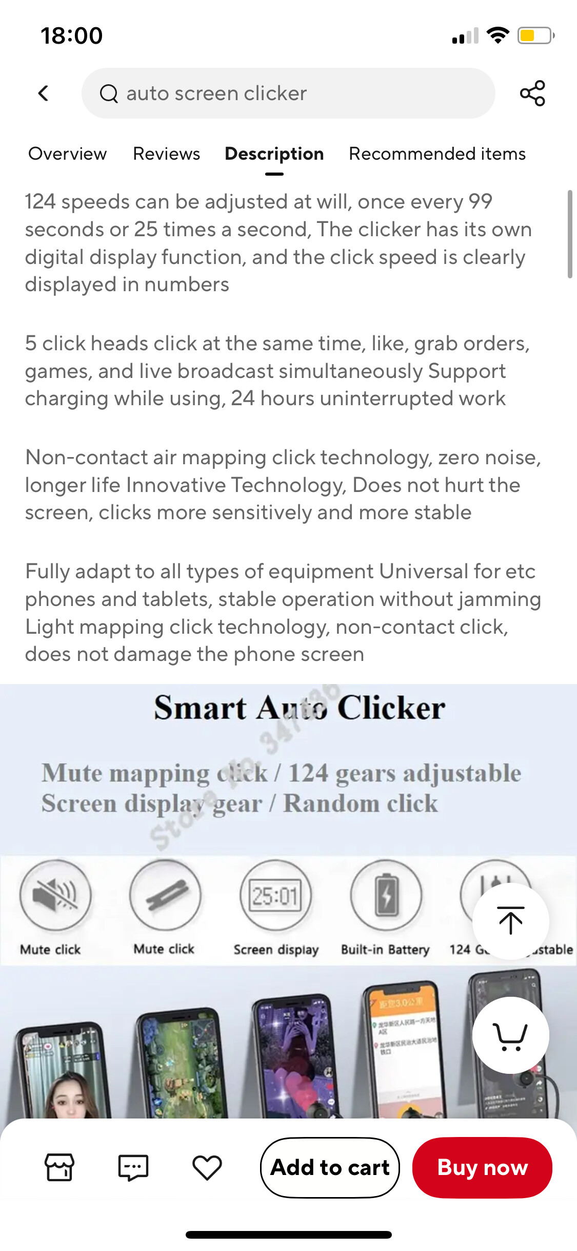

Besides that, I can’t find a way to connect the auto clickers on the arduino. These are the auto coickers:

Hi guys, thanks for answering.
The clickers come from this device:
Does it clarify? If not I will need to contact the seller
Oh, so it's some sort of device that simulates a human finger tap on a touchscreen?
The problem with repurposing parts of a device is that the original manufacturer likely won't detail the signals/connections, as it's not something that is required in order to operate the device. The intention being that the user just plugs it into the controller and uses it.
Exactly. Can’t I use theme as hardware? So the arduino uses them to touch my screen at regular intervals?
In the total absence of any technical information about them, it's safest to assume they would damage the Arduino if connected directly to it.

I think it simulates a finger-click on a smartphone/tablet touch screen. People use them to build up large numbers of fake "likes" for themselves on social media, to impress their friends and boost their egos. The clicker has a suction cup allowing it to be stuck on just the right point on the screen.

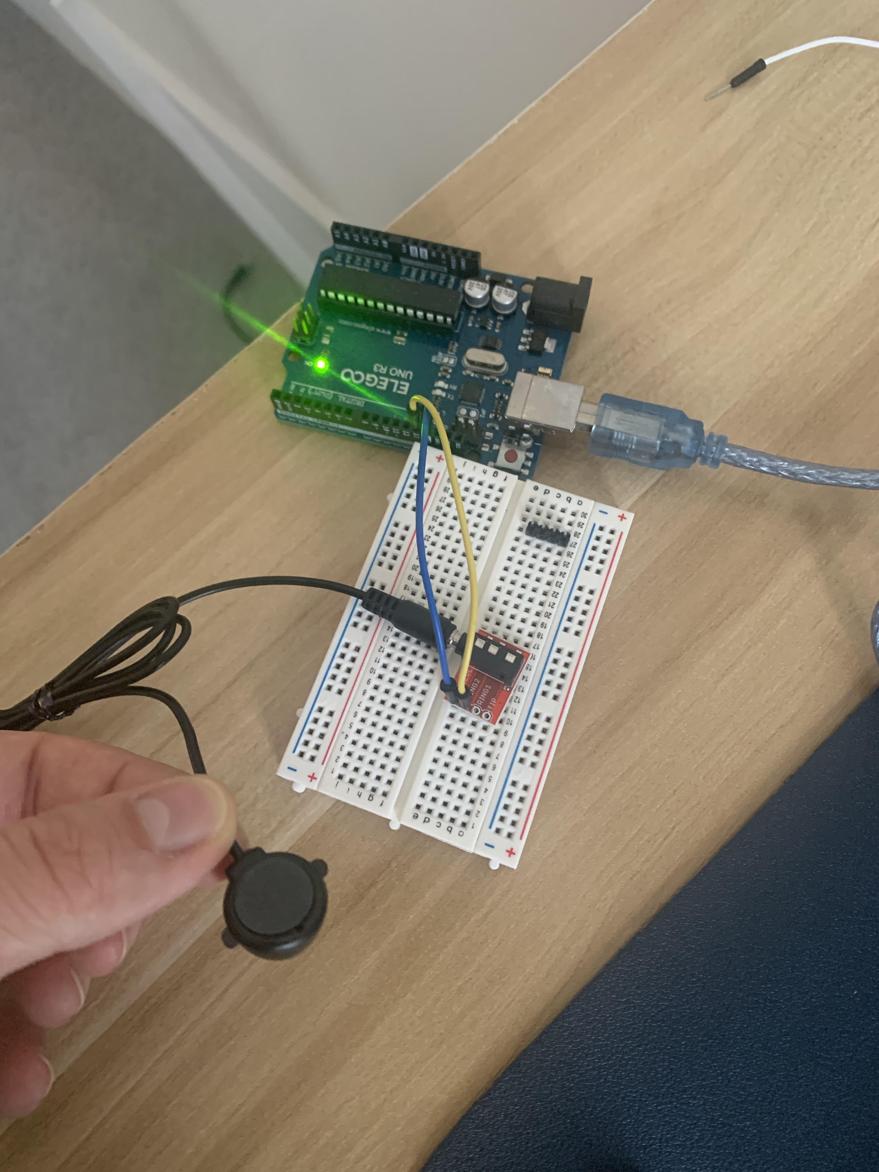

There are 3 wires inside, one blue, one yellow and another orange/redish
I got some news, this little device arrived. Any suggestion regarding how to properly connect it to the arduino, and what would be the code to make it function?
