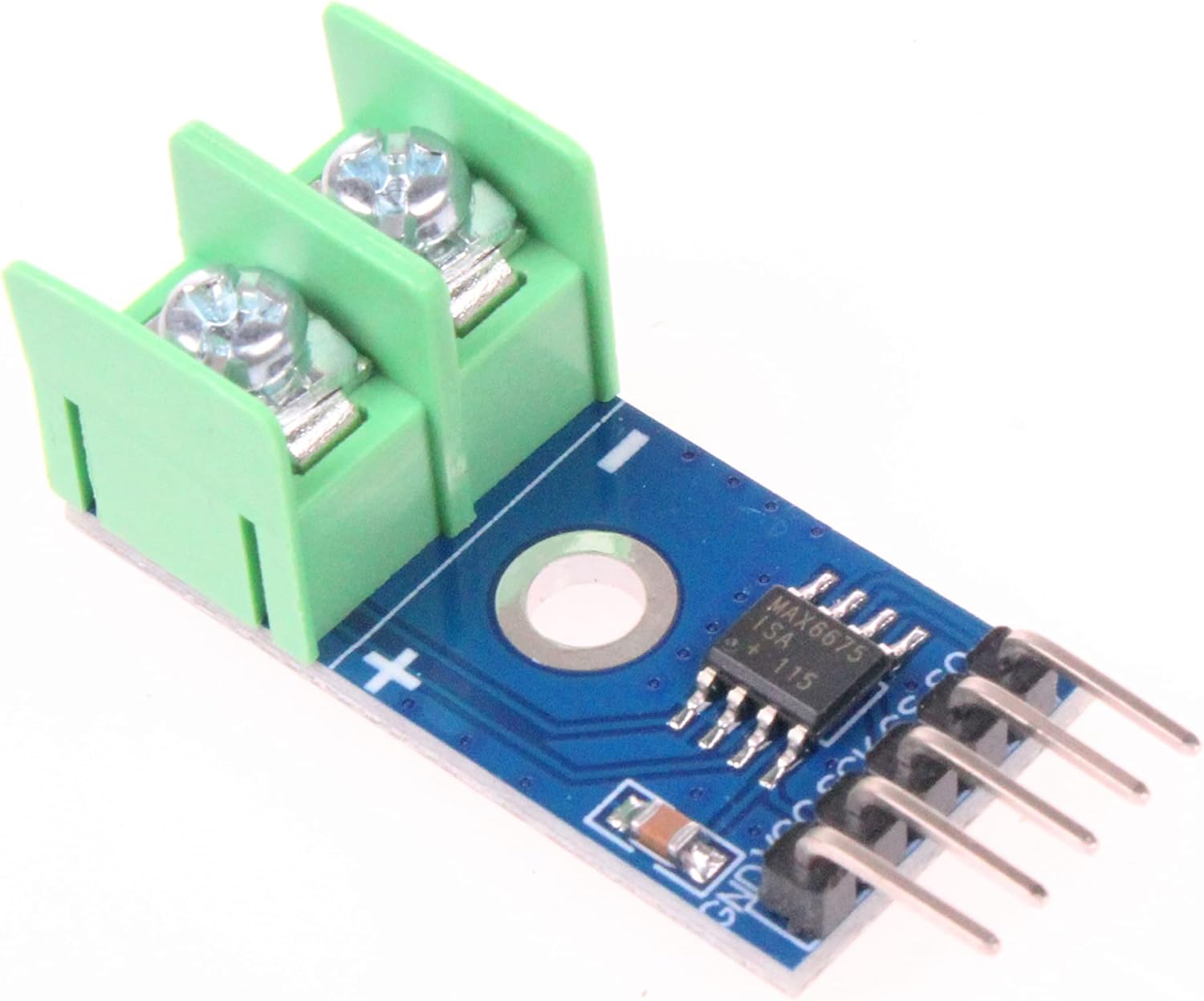

Hi, I am trying to connect a k type thermocouple to an Arduino uno but I have a problem in choosing the amplifier, if anyone could guide me? I attached a link of the thermocoupe I am using, i would like to ask if MAX6675 works with this K thermocouple?

is the connection possible, if not, what other component I could use to make it work?

The MAX6675 is intended for use with a type-K thermocouple, so it should be satisfactory.

ooh sorry for the inconvience, here is the link of the module I intend to buy, it's just that I am not sure the Thermocouple can fit in the screw holes.
The module you are looking at will do just fine. As to connecting you will need to cut off the Type K thermocouple plug because there is no way it will mate with the MAX6675 module. Another option is your thermocouples come with the standard Type K male plug which as I mentioned you either cut off or buy a mating female socket for and then use Type K extension wire to connect to your module. Note the polarity and on a standard Type K thermocouple the negative pin has the larger diameter and is the magnetic pin. So no, as shown you will not be able to connect the TC plug to the MAX6675 module unless yo0u cut the plug off. That or just open the connector and disconnect the TC wires.
Looking at the images I can't quite tell if the connectors shown are a TC Mini connector or standard not that it matters much. :slight_smile:
Just make sure the thermocouple you buy is the TC you want/need.
