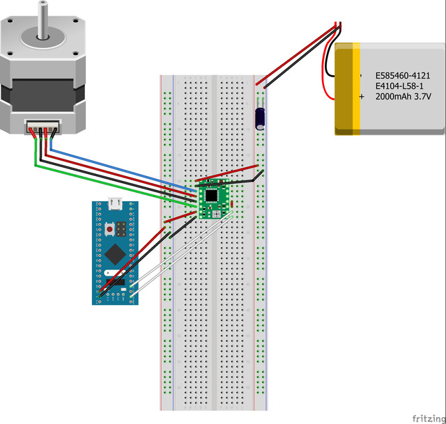

I did everythink right like there is in this photo, connect every pin like is show and my stepper motor do nothink :/. Do u have any idea why?
Maybe you don't have any code to drive it? Or the code you have but haven't shown us is bad? Or your wiring is wrong e.g. no pin numbers are shown on the "microcontroller" (what is it ?). Or perhaps you have connected the capacitor the wrong way round?
We know that your "motor power supply" is a 3S Lipo but what is your "logic power supply"?
How about posting a picture of your setup so we can see for ourselves that you have done everything right?
Steve
Okey so i made a pictue of my setup. its just a schemat because i couldnt get stm32f407G board in this program so i add random one. I wire pin PA1 to step and PA2 to dir. Logic supply is from microcontroler wire 5v and GND. I use capicitor 100µF and this LiPo is a random Lipo like microcontroler. Here is my code, i took it from one of the examples and changed for stm32 board. I used Arduino IDE couse the board im using which is stm32f407G-DISC1 can be programed there.

A4988 requires at least 8V to work.
You will NOT have it working at 4.2V.
