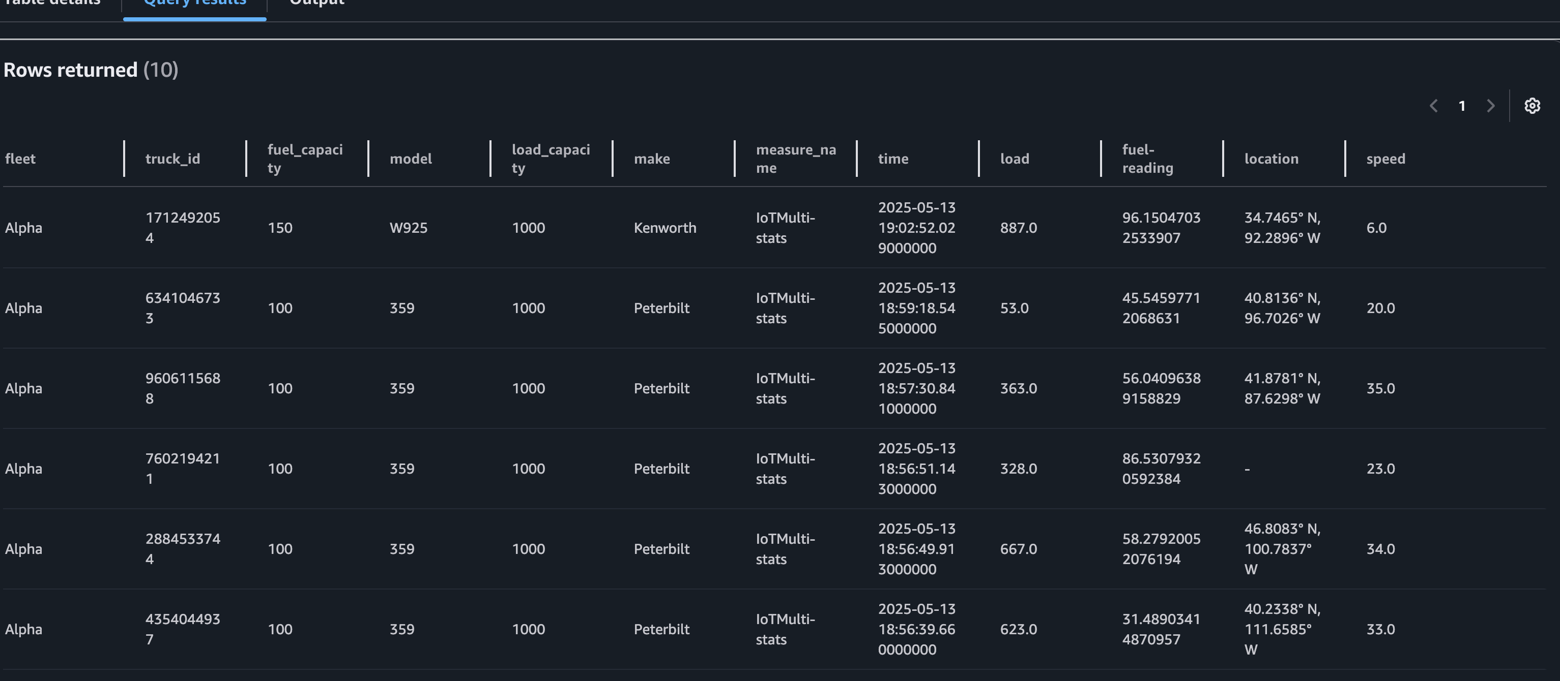

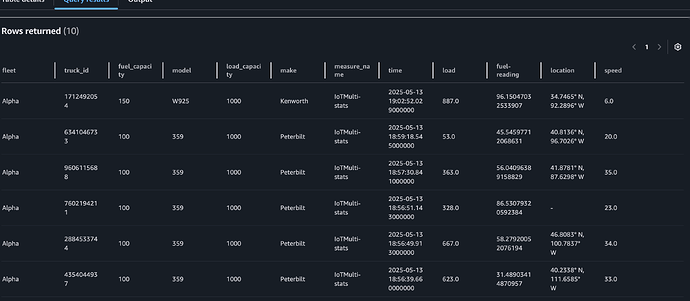

Thanks for the docs. I've seen other evidence that it does support it. If you create the sample database on AWS, you get an option to create single or multi measure records. I've queried that data and it does show multiple values per record. I do believe it is possible.
