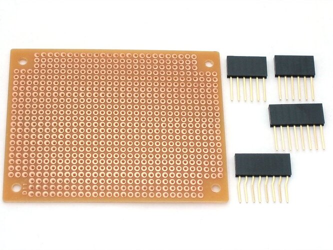

On the Arduino UNO there is a gap between pins 7 & 8, and another between pins A0 & Vin. In the case of 7 & 8, the gap means that the sockets do not match with adjacent pins mounted in a perfboard; A0 & Vin will match 2 of three pins in a perfboard.
Assuming I want to make a shield from perfboard to fit a UNO, and that I need to use pins 7 & 8, I have something of a problem.

You can make an interface header by bending pins so things fit.
You can buy pre-bent pins.

DIY shield for Arduino : ID 187 : $6.00 : Adafruit Industries, Unique & fun DIY electronics and kits
Sadly, if you follow that link you will find that they are 'discontinued'.
I guess it's a case of pin bending.

What about this technique
http://www.thebox.myzen.co.uk/Hardware/Arduino_Shield.html
Thanks Grumpy_Mike
The half-way holes are my solution.
