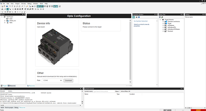

Connection Error
The image above shows what happens if I try and connect, I get an error in the right corner. But also my software freezes most of the time . im newer here... can anyone help me step by step to resolve this error !?
Sorry not at this time. You need to post an annotated schematic showing exactly how this is wired in your system and your code using code tags to post your code. Be sure to post a complete schematic and code.
Sketch generated, is changed: false

Hello,
You have mean like this ?
No!
Try this link: what is a schematic at DuckDuckGo
I have to start new schema... and i get this error, if you see photo thats was empty...
Try to upload and run the Arduino IDE example STM32H747_System > QSPIFormat
and then the entire Arduino PLC IDE Process
Hello,
Ca you please provide to me step by step this action?
> Arduino IDE - File - Examples - STM32H747_System > QSPIFormat
than upload Right ? I do but i got some error !
Hi @fisniku123 ,
Please perform the following steps using Arduino IDE:
  1. Install/Update the latest core version of Arduino Mbed OS Opta Boards: In Arduino IDE go to Tools > Board > Boards Manager and search 'Opta'. Install/Update Arduino Mbed OS Opta Boards.
  2. Implement the Memory Partitioning tutorial. Make sure the code execution is completed successfully by following the output of the serial monitor.
After completing these steps, close the Serial Monitor, open the PLC IDE, create a new project, and follow the steps indicated in this tutorial:
I hope you find this useful :slight_smile:
Best,
Hello, i have try and change the code Memory Partitioning tutorial but i think problems is with serial port... or pc driver, on this pc i can connect and upload with openplc but with arduino plc ide i get this error.
Ok Fix it with Zadig i have replace the drivers with USB Serial (CDC).
After this i have use low port nr in bootingloader in my caus Port com3 and on-line setup communication ModBus i select Port com6. Thank you.
