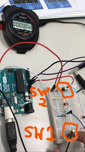

Thank you for your answer. down here is my actual circuit and stopwatch sorry if you cant see it clearly.
I am so sorry because I don't know how to put image in this reply box accept attach the image file.
in this picture the circle mark I wrote is the button.

yes the switches is saperated from the stopwatch. How I want it to work is to make the SW1 as the start button and SW2 as the stop button, how actually this circuit move is. when push the SW1, the transistor Switch circuit ( circuit between SW1 and SW2 in the picture)will turn ON and then, at the moment the positive pole and negative pole of the stopwatch will be connected mean that getting an electric signal (for this moment the stopwatch will start running). after releasing the button the transistor switch circuit will turn OFF and the stopwatch not getting any signal so the time will continue running.
when SW2 pushed, same as when pushing the SW1 button. the difference is just when the stopwatch detect any electric signal the stopwatch will stop running.

actually my project is to make a sensor in a track field event such as 100m and so on. at the goal line I will put IR sensor to measure the time of the running. so as my final target is i want to replace SW1 with a starting gun and replace SW2 with the IR sensor. for now my IR sensor, starting gun and transistor switch circuit works like I want. and now I just need to make a program to run this system. to make my experiment simpler i just used these two switches.
do you mean that I need to make two pins of ST pin?
If the stopwatch has separate start and stop switches then, yes, you need to use separate outputs from the Arduino to control them. One to start the stopwatch and one to stop the stopwatch.
It is difficult to see from your photo, but have you currently got the stop and start working with mechanical external switches and now you want to move to using Arduino outputs to do the same ?

yes, i want to do it the same. I'll try try it tomorrow (here japan is night right now). Thanks for the sharing :slight_smile:
when you said I need to use 2 pins instead of 1 ST pin, I don't know where to put the second pin in this circuit. here is the circuit's picture. and I think I have make it clearer than yesterday. Sorry for taking your time again....
